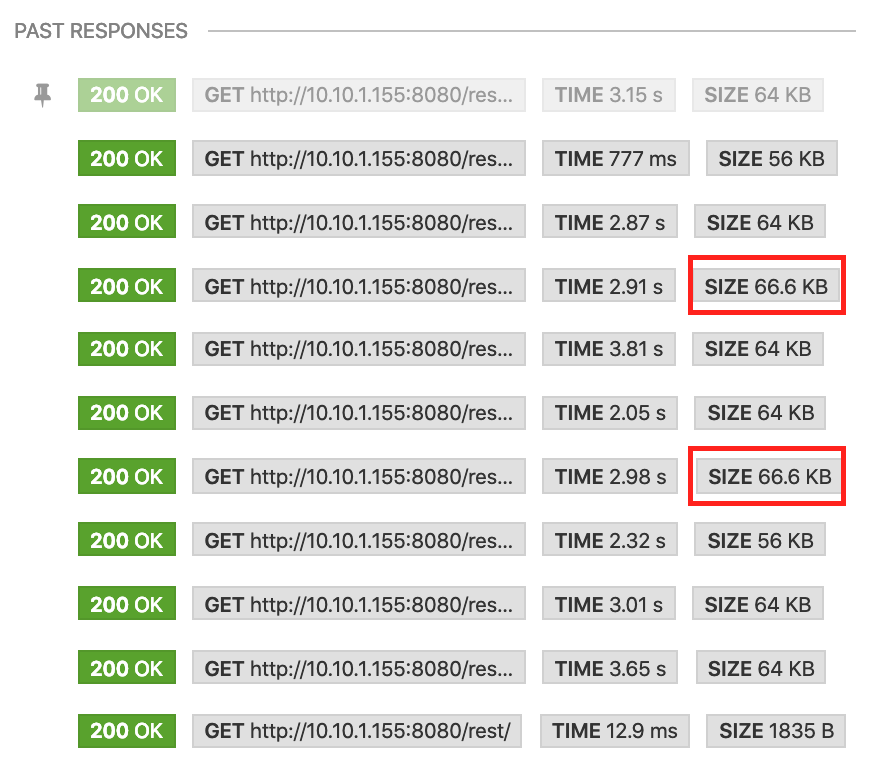

I’m facing a problem with the REST response. I discovered this while playing around with Node-RED, because the module I use there calls OH2’s REST API to get all available items.
I tested a dedicated REST client application, the response is not complete there, too. If I fire the request several times, it is cut off at different locations. Sometimes the response in 64KB, but sometimes it’s only 56KB. Everytime the request gets a HTTP/200 OK.
When I try to execute this request via the API documentation, there is an error code shown.
The OH2 installation runs virtualized on Ubuntu 18.04 on a VMWare ESXi with 4 CPUs / 16 GB RAM / 200GB SSD storage, so I don’t think that the sizing is a problem here.
It was working for me, too, for approx. 30 seconds. Both API documentation “Try Me” and REST client got a complete, parsable response.
Now - without changing anything, it is cut off, again.
I got two successful responses in the tests. Basically it’s working 5% of the time. I have no idea where to look, now
I watched the log files closely, there is only one error from the amazonecho-binding, where some Amazon-URL-calls are failing. I nevertheless uninstalled the binding, restarted OH2, and now it is working. 10/10 REST tests were successfully. I will continue to watch this, and I’m trying to check why the amazonecho-binding was failing.
But strange, that an individual binding error leads to incomplete REST responses.
One remark: now the request is handled within 50ms, with the incomplete responses before I was >2000ms. Probably some timeout somewhere while constructing the response…
