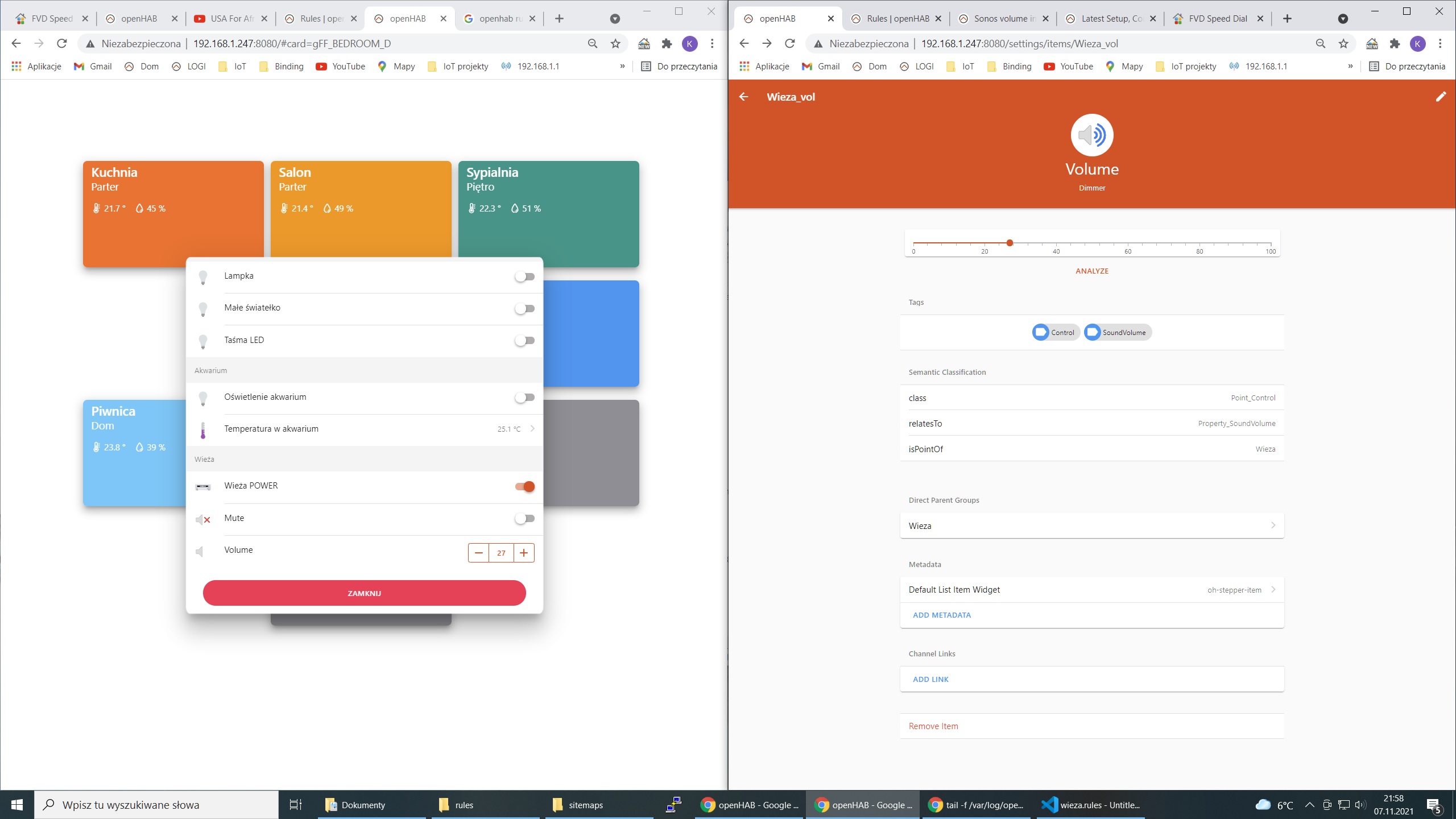

I’m ussing ESP with IR and Tasmota to control my old radio by sending IR codes.
It works OK (I can power it on/off from MainUI) but I can send only VOL+ from mainUI (I add slider with list widget oh-setpoint)
It doesn’t metter that i pres _ or + it always send VOL+ :frowning:
(I don’t need to remember last volume it isn’t important because usually I’m using remote control)

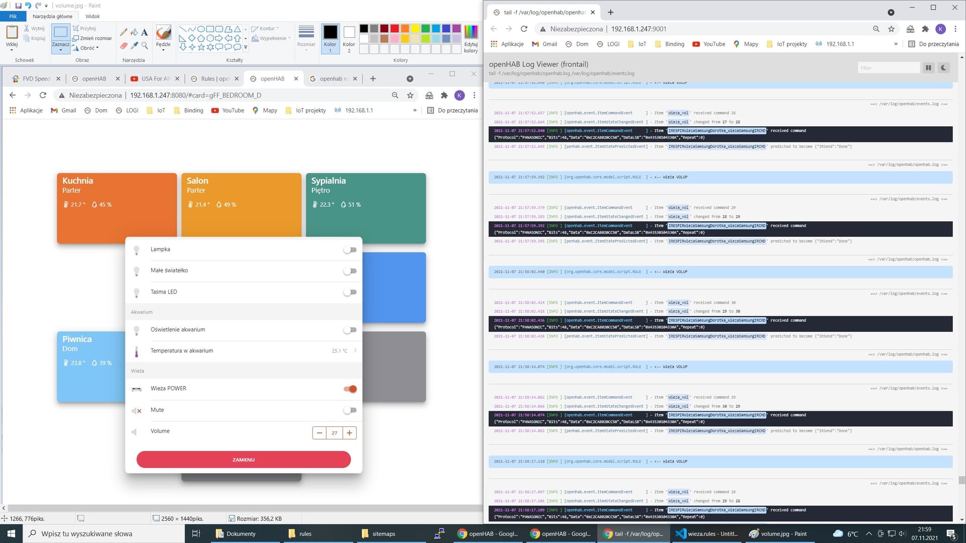

What commands does that send to your Item?
Look in your events.log to see.
Consider having your rule respond to commands, not Item state.
The variable Vold is set to null every time the rule runs. There’s not much point in comparing that to anything.
