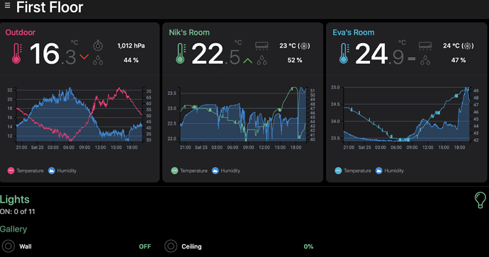

I want to use in my openHAB 3.2.0 (on RASPI 3) environment the following Script/Rule, to display the ‘Temperature Trend’ in my Habpanel, but if i run the rule the system get’s extremly slow and things began to go offline and online as i can see in the log file.
This what i want to do:
This is the Script/Rule that calculate average of last 1h - first 30 mins compared to last 30 minutes of the hour - and based on that posts an update that i use:
  • 1 if temperature is raising,
  • 0 if temperature did not change,
  • -1 if temperature is falling.

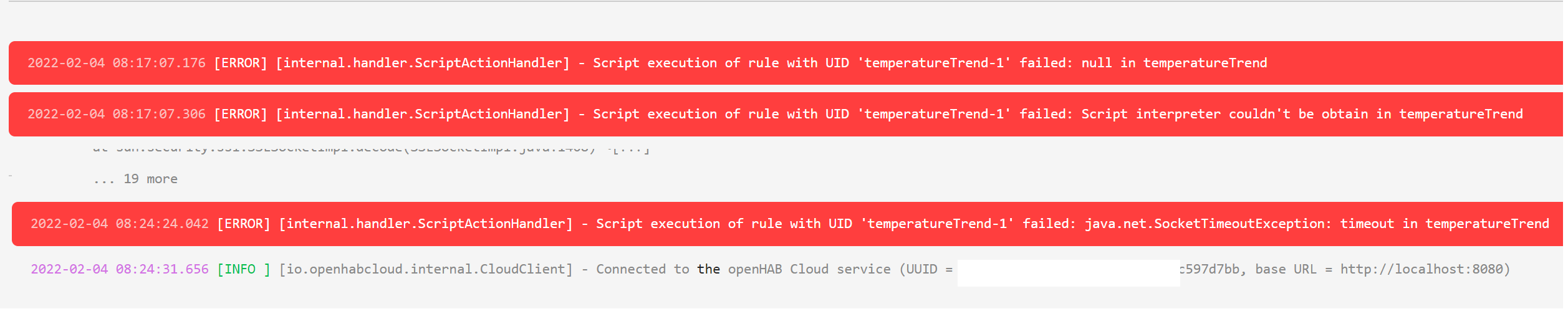

and this is what i get in the log-file when the script is running:
as i told, the system begans to get extremley slow, so i have to disable the script/rule and reboot the system.
