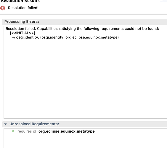

When I try to click Resolve buttons, it informs me that:

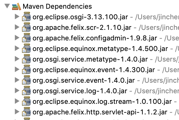

I can find this jar in the maven dependency, but it seems that it greys out. I guess this is the main reason but I don’t know how to solve it. Could anyone give me some hints?

Hi, I have tried closing the project and reopern it, but it doesn’t work. Actually after reopening, I can see many bundles in the repo, so the first problem has been figured out. However for the second, it still shows me that Capabilities could not be found!

That is right. It is the same error, which shows me resolution failed.
It seems all dependencies are still in grey. It is weird.

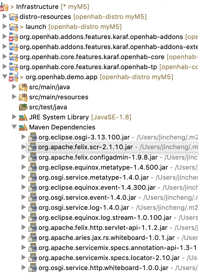

I also see a error indicator on the demo app. Why is that? And did you include those other features project for a reason?
Jony
(Tom Bruce)
November 28, 2019, 10:49am
7
Please let me check the error, thanks! I used to think that demo would download dependencies online instead of local repos.
