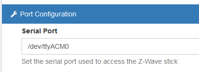

You need to set the correct port for your zwave controller:
Find the correct port for example via
dmesg -T | grep tty
