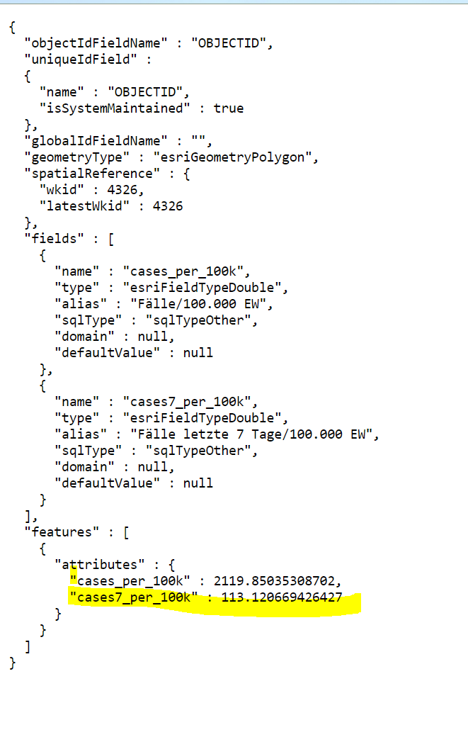

Dear all,
i have OH3 running, HTTP binduing and JSONPATH transform installed.
I have this URL:
https://services7.arcgis.com/mOBPykOjAyBO2ZKk/arcgis/rest/services/RKI_Landkreisdaten/FeatureServer/0/query?where=&objectIds=76&time=&geometry=&geometryType=esriGeometryEnvelope&inSR=&spatialRel=esriSpatialRelIntersects&resultType=none&distance=0.0&units=esriSRUnit_Meter&returnGeodetic=false&outFields=cases_per_100k%2Ccases7_per_100k&returnGeometry=false&returnCentroid=false&featureEncoding=esriDefault&multipatchOption=xyFootprint&maxAllowableOffset=&geometryPrecision=&outSR=4326&datumTransformation=&applyVCSProjection=false&returnIdsOnly=false&returnUniqueIdsOnly=false&returnCountOnly=false&returnExtentOnly=false&returnQueryGeometry=false&returnDistinctValues=false&cacheHint=false&orderByFields=&groupByFieldsForStatistics=&outStatistics=&having=&resultOffset=&resultRecordCount=&returnZ=false&returnM=false&returnExceededLimitFeatures=true&quantizationParameters=&sqlFormat=none&f=pjson&token=
It returns:
"objectIdFieldName" : "OBJECTID",
"uniqueIdField" :
"name" : "OBJECTID",
"isSystemMaintained" : true
"globalIdFieldName" : "",
"geometryType" : "esriGeometryPolygon",
"spatialReference" : {
"wkid" : 4326,
"latestWkid" : 4326
"fields" : [
"name" : "cases_per_100k",
"type" : "esriFieldTypeDouble",
"alias" : "Fälle/100.000 EW",
"sqlType" : "sqlTypeOther",
"domain" : null,
"defaultValue" : null
"name" : "cases7_per_100k",
"alias" : "Fälle letzte 7 Tage/100.000 EW",
"domain" : null,
"features" : [
"attributes" : {
"cases_per_100k" : 2119.85035308702,
"cases7_per_100k" : 113.120669426427

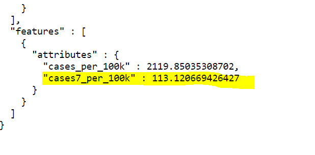

I would like to extract the value in ‘cases_per_100k’.

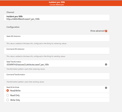

- id: cases7_per_100k
channelTypeUID: http:number
label: Inzident pro 100k
description: null
configuration:
stateTransformation: JSONPATH:$.features.attributes.cases7_per_100k

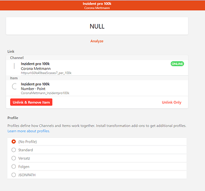

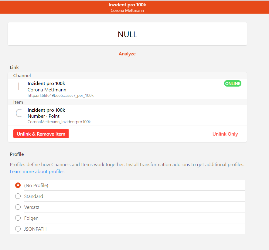

But when I check, the valoue remains empty:
But it shoudl be
Any help appreciated!
Can you copy/paste the JSON into your post, rather than a screenshot? Allows us to quickly test…
Matt_Hias
(Matt Hias)
January 16, 2021, 6:39pm
3
I added the JSON, which is returned.

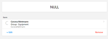

Are you aware that the screenshot of the Item you’re showing us is of a Group Item? What Item do you actually have linked to the cases7_per_100k Channel?

This is the config of the channel:
and the linked item:

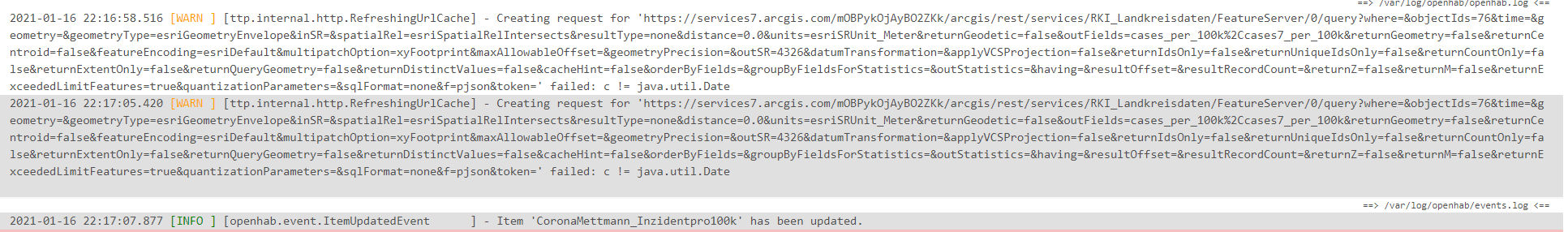

In the logs, there is a waring, which is related to this topic:
2021-01-16 22:57:45.548 [WARN ] [ttp.internal.http.RefreshingUrlCache] - Creating request for 'https://services7.arcgis.com/mOBPykOjAyBO2ZKk/arcgis/rest/services/RKI_Landkreisdaten/FeatureServer/0/query?where=&objectIds=76&time=&geometry=&geometryType=esriGeometryEnvelope&inSR=&spatialRel=esriSpatialRelIntersects&resultType=none&distance=0.0&units=esriSRUnit_Meter&returnGeodetic=false&outFields=cases_per_100k%2Ccases7_per_100k&returnGeometry=false&returnCentroid=false&featureEncoding=esriDefault&multipatchOption=xyFootprint&maxAllowableOffset=&geometryPrecision=&outSR=4326&datumTransformation=&applyVCSProjection=false&returnIdsOnly=false&returnUniqueIdsOnly=false&returnCountOnly=false&returnExtentOnly=false&returnQueryGeometry=false&returnDistinctValues=false&cacheHint=false&orderByFields=&groupByFieldsForStatistics=&outStatistics=&having=&resultOffset=&resultRecordCount=&returnZ=false&returnM=false&returnExceededLimitFeatures=true&quantizationParameters=&sqlFormat=none&f=pjson&token=' failed: c != java.util.Date
Yes, so as I thought: this isn’t about the JSONPATH at all - something’s going wrong requesting the data?
Unfortunately I can’t help further as I have no idea what the error means! @J-N-K might be able to help (sorry for the ping), but please copy/paste the WARN message info your post, rather than a screenshot…
J-N-K
(Jan N. Klug)
January 16, 2021, 10:54pm
10
The problem is %2c which the binding tries to use as formatter input. Try replacing that with a ,.

thanks to @hafniumzinc and @J-N-K . Not it works. I’ll adopt a bit and share afterwards here.
