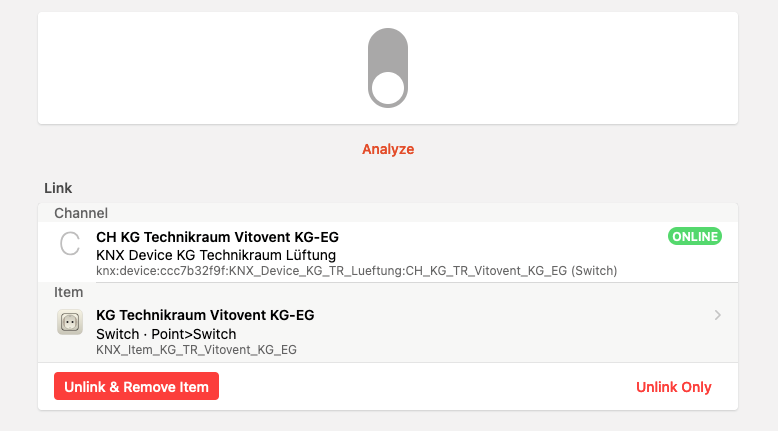

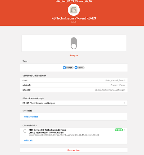

I added 2 switching channels and they are signaled as online.
I linked an Item per channel but as a result I get only NULL.

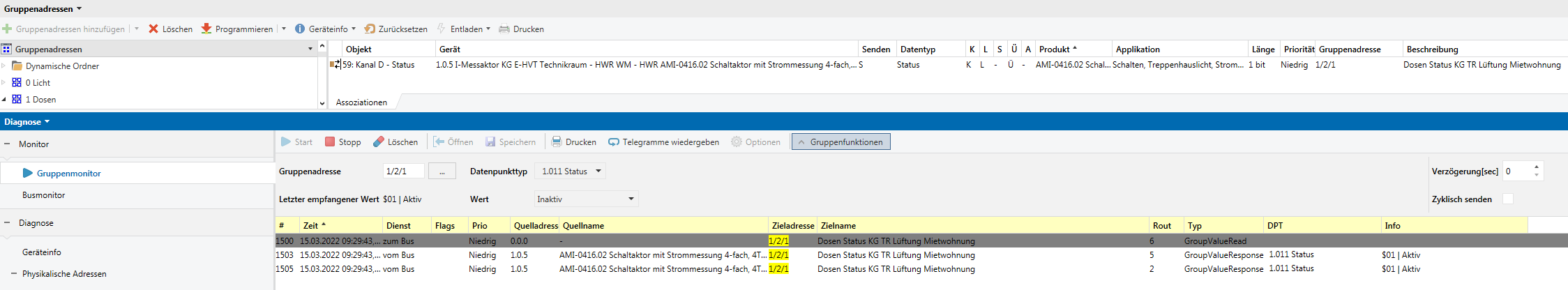

Here a ETS screen shot of one of the mentioned GA and a corresponding trace via bus monitor. The flags are set correctly and the device reacts with a GroupValueResponse.

thanks for your investigations. I tried it as well (disable / enable Thing) but I didn’t see any query in ETS Group Monitor.
Sending a Read request from ETS is answered 4 times. In this special case the GA is only set in the Actor but no other KNX device. It is only used in OH3 because it is a fan which shouldn’t be deactivated by hand. Seems there are no Acks sent by OH?!?
Other identical Actors with a GA set in a KNX switch and the Actor are anwered just once.
