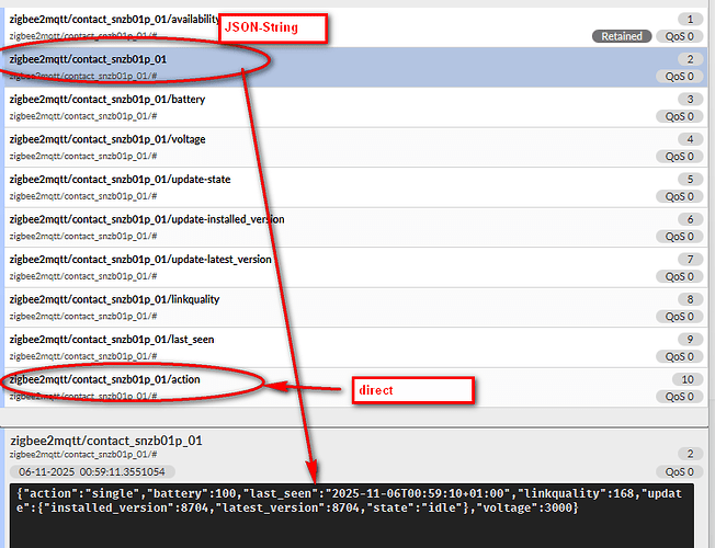

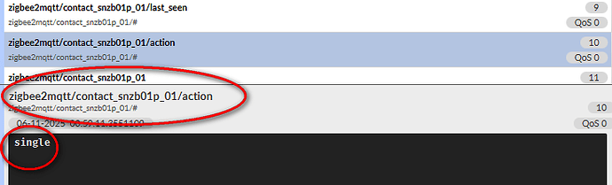

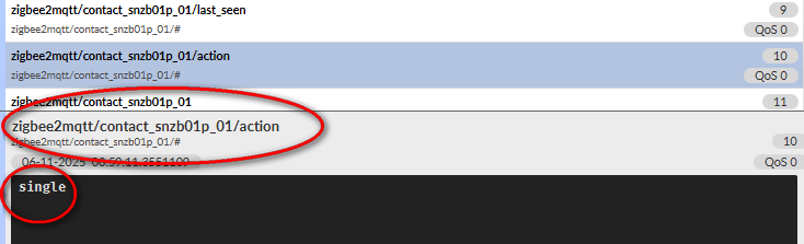

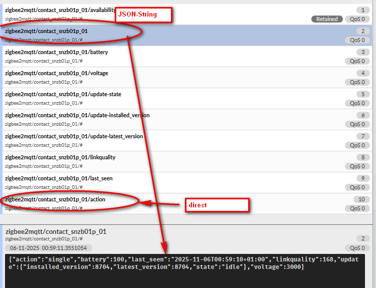

That’s great, if everything now works. BTW I saw that my Trigger-Channel uses the direct payload. So if you want to use the JSONPATH one have to add a transformationPattern=“JSONPATH:$.action”
I mix sometimes the possibilities as I can use both ways.

Yeah, this is exactly what I had to do. Mine doesn’t have the direct topic. I had to pull it from the payload using this exact JSONPATH.
Thanks again!
