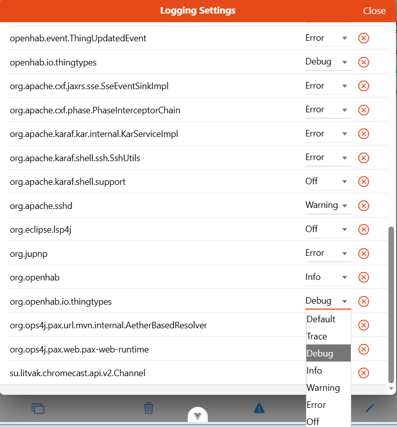

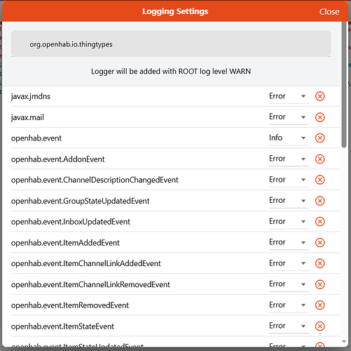

Then, set the log level for org.openhab.io.thingtypes to DEBUG. You can do that from the log viewer:
Click the little “gear” in the lower right corner, and this window will appear:
Type in/paste org.openhab.io.thingtypes on the top and press Enter. Nothing “obvious” will happen, but it will then appear in the list below. Navigate/find it, and make sure it’s set to Debug:

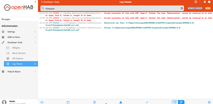

Once that is done, you should see something in the log viewer as soon as you move a file into or out of the $OPENHAB_CONF/thingtypes folder.

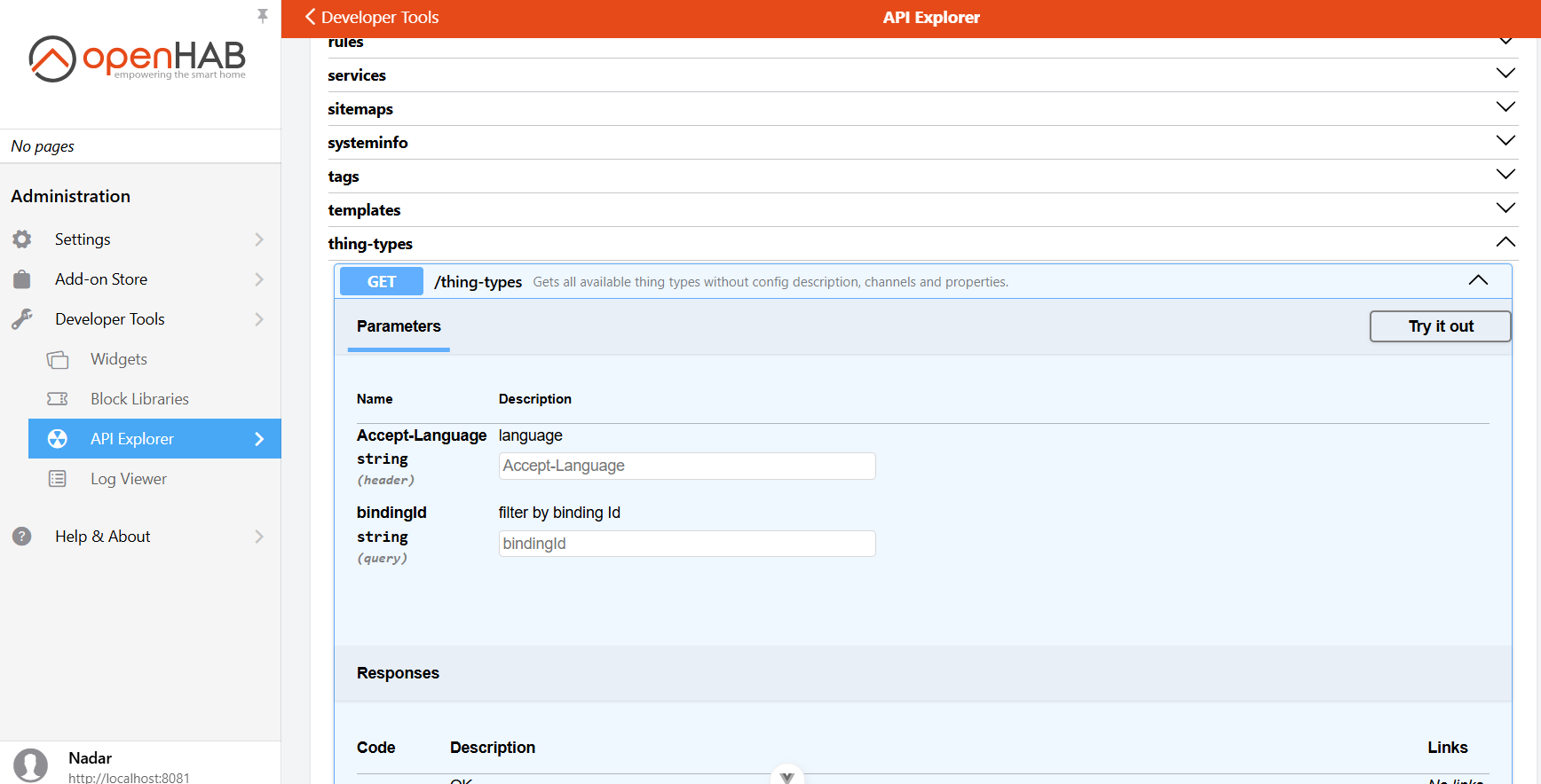

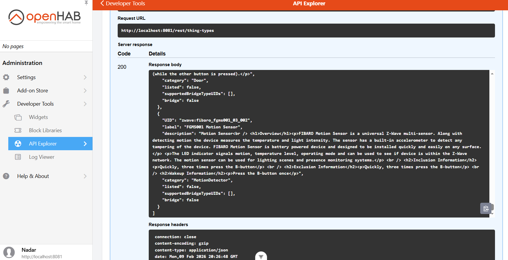

Once this is done, you can use the API Explorer to check if the files have been registered:
Click “try it out” and then “Execute”.
This will generate a long JSON of all registered thing-types on your system:
You can click the “copy button” in the right lower corner and then paste it into any text editor. There you can search for and inspect the result of the XML files you have added. You can also use a binding ID to “filter” the results from the API, to get less results, or if you know the thing-type ID, you can query that directly using the other API endpoint for thing-types:
Once you see that your XML has been registered correctly, restart OH, and the Z-Wave binding should be able to recognize the device.

The way to set the log level from the Karaf console should be:
log:set DEBUG org.openhab.io.thingtypes
For some reason however, this doesn’t work for me, it just responds with:
Error executing command: Unable to set level for logger
I don’t know why, I rarely use Karaf for such things. The other alternative is editing the logging configuration file manually:
One way or another, we need DEBUG logging to be enabled for org.openhab.io.thingtypes to see if it’s parsing the files or not. Once everything works, the DEBUG logging can be removed/set back to INFO again.

I probably shouldn’t have edited my 2nd post to show the data from API Explorer (I would have saved you all of the screenshots, etc. – but I have no doubt sure someone may find it useful in the future.)
I’m reposting API Explorer device entry here:
    "UID": "zwave:zooz_zen58_00_000",
    "label": "ZEN58 XS Low Voltage Relay",
    "description": "XS Low Voltage Relay<br /> <h1>Overview</h1><p>Manual or z-wave on/off control for low voltage loads.  </p><p>Monitors analog dry contact inputs like open/close sensors.  </p><p>Installs behind your existing wall switch (single pole or 3-way).  </p><p>Z-wave Long Range for next -level wireless network</p><p>Remembers and restores on/off status after power failure</p><p>800 series z-wave and s2 SmartStart security.</p><p>Specs: </p><p>Power 9-40v ac/dc</p><p>Max load: 3A @ 240V.</p><p>Range: up to 300ft LoS and 1300ft with zwave long range enabled. </p><p>Indoor use only.</p><p>1.2\"x1\"x0.6\" (its so tiny!)</p> <br /> <h2>Inclusion Information</h2><p>Initiate inclusion on hub and press the z-wave button 3 times as quickly as possible.</p> <br /> <h2>Exclusion Information</h2><p>Initiate exclusion on hub and press the z-wave button 3 times as quickly as possible.</p> <br /> <h2>Wakeup Information</h2><p><br /></p>",
    "category": "Valve",
    "listed": false,
    "supportedBridgeTypeUIDs": [],
    "bridge": false
It looks like the listing is there. Am I right to assume the issue is with xml then?

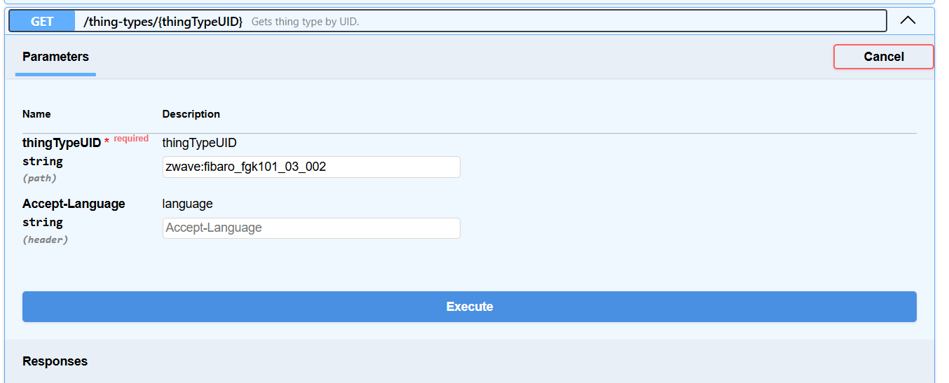

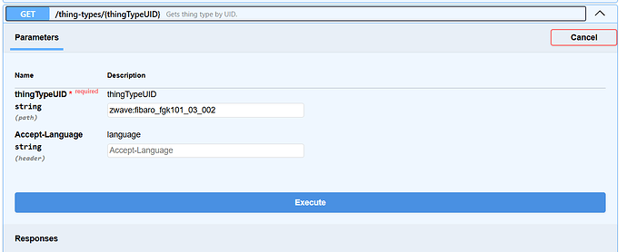

It seems like the add-on is working then. If you use the second thing-type endpoint, where you specify the thing-type UID (zwave:zooz_zen58_00_000), you’ll get some more info about channels and properties, for example:
  "channels": [
      "description": "Batterinivå i prosent (0-100%)",
      "id": "battery-level",
      "label": "Batterinivå",
      "tags": [
        "Energy",
        "Measurement"
      "properties": {
        "binding:*:PercentType": "COMMAND_CLASS_BATTERY"
      "category": "Battery",
      "stateDescription": {
        "minimum": 0,
        "maximum": 100,
        "step": 1,
        "pattern": "%.0f %%",
        "readOnly": true,
        "options": []
      "advanced": false,
      "typeUID": "system:battery-level"
  "channelGroups": [],
  "configParameters": [],
  "parameterGroups": [],
  "properties": {
    "versionMin": "3.2",
    "modelId": "FGK101",
    "vendor": "Fibargroup",
    "defaultAssociations": "1",
    "manufacturerId": "010F",
    "manufacturerRef": "0701:1001,0701:2001,0701:3001",
    "dbReference": "381"
  "extensibleChannelTypeIds": [],
  "UID": "zwave:fibaro_fgk101_03_002",
  "label": "FGK101 Door Opening Sensor",
  "description": "Door Opening Sensor<br /> <h1>Overview</h1><p><strong>FIBARO Door/Window Sensor</strong> is a wireless, battery powered reed sensor compatible with the Z-Wave standard. Changing the device’s status will automatically send signal to the Z-Wave controller and associated devices. </p> <p>Sensor can be used to trigger scenes and everywhere there is a need for information about opening or closing of doors, windows, garage doors, etc. Opening is detected by separating the sensor’s body and the magnet.</p> <p>In addition the FIBARO Door/Window Sensor supports one DS18B20 temperature sensor and has one potential free input.</p> <br /> <h2>Inclusion Information</h2><p>Quickly, three times press the TMP button. </p> <br /> <h2>Exclusion Information</h2><p>Quickly, three times press the TMP button. </p> <br /> <h2>Wakeup Information</h2><p>To wake up the sensor manually, click one of the TMP buttons (while the other button is pressed).</p>",
  "category": "Door",
  "listed": false,
  "bridge": false
Does that seem to be populated as well?

Thing “Thing Type Provider” is actually a channel type provider and channel group type provider too. So, depending on what the XML contains, it could be necessary to check any added channel types in the API explorer too.
The name of the XML file doesn’t matter at all. When I create a file and paste the content you posted into it, it is picked up and I get this when I query zwave:zooz_zen58_00_000:
  "channels": [],
  "properties": {
    "modelId": "ZEN58",
    "vendor": "Zooz",
    "manufacturerId": "027A",
    "manufacturerRef": "0004:0322",
    "dbReference": "1687"
  "listed": false,
  "bridge": false
So, the file itself seems to “work”. When it comes to whether the necessary information is in the file, I can’t really say, I think @apella12 is much better suited to answer that.
It does strike me a bit odd that the definition shows no channels… that might be part of the problem.
There is one more thing to check. I think there should be an XML file in the userdata/zwave folder (it is different from the one you downloaded from the binding). Check this line "manufacturerRef": "0004:0322"in both files. Devices do not go by model ZEN58, but by these values. They need to be the same.
EDIT: There are also two additional things I’m not wild about in the downloaded XML (from the binding). The device is new, so not sure how much has been tested. I don’t think they are related to your current issue but could cause problems down the line.

I see now that there is a problem with the XML, I found this error in my log:
com.thoughtworks.xstream.io.StreamException:
at com.thoughtworks.xstream.io.xml.StaxReader.pullNextEvent(StaxReader.java:74)
at com.thoughtworks.xstream.io.xml.AbstractPullReader.readRealEvent(AbstractPullReader.java:148)
at com.thoughtworks.xstream.io.xml.AbstractPullReader.readEvent(AbstractPullReader.java:141)
at com.thoughtworks.xstream.io.xml.AbstractPullReader.move(AbstractPullReader.java:118)
at com.thoughtworks.xstream.io.xml.AbstractPullReader.moveDown(AbstractPullReader.java:103)
at com.thoughtworks.xstream.io.xml.StaxReader.<init>(StaxReader.java:45)
at com.thoughtworks.xstream.io.xml.StaxDriver.createStaxReader(StaxDriver.java:173)
at com.thoughtworks.xstream.io.xml.StaxDriver.createReader(StaxDriver.java:110)
at com.thoughtworks.xstream.XStream.fromXML(XStream.java:1391)
at com.thoughtworks.xstream.XStream.fromXML(XStream.java:1345)
at org.openhab.core.config.core.xml.util.XmlDocumentReader.readFromXML(XmlDocumentReader.java:106)
at org.openhab.io.thingtypes.internal.FileProcessor.add(FileProcessor.java:193)
at org.openhab.io.thingtypes.internal.FileProcessor.processWatchEvent(FileProcessor.java:165)
at org.openhab.core.internal.service.WatchServiceImpl$Listener.notify(WatchServiceImpl.java:293)
at org.openhab.core.internal.service.WatchServiceImpl.lambda$6(WatchServiceImpl.java:278)
at java.base/java.util.stream.ForEachOps$ForEachOp$OfRef.accept(ForEachOps.java:184)
at java.base/java.util.stream.ReferencePipeline$2$1.accept(ReferencePipeline.java:179)
at java.base/java.util.Spliterators$ArraySpliterator.forEachRemaining(Spliterators.java:1024)
at java.base/java.util.stream.AbstractPipeline.copyInto(AbstractPipeline.java:509)
at java.base/java.util.stream.AbstractPipeline.wrapAndCopyInto(AbstractPipeline.java:499)
at java.base/java.util.stream.ForEachOps$ForEachOp.evaluateSequential(ForEachOps.java:151)
at java.base/java.util.stream.ForEachOps$ForEachOp$OfRef.evaluateSequential(ForEachOps.java:174)
at java.base/java.util.stream.AbstractPipeline.evaluate(AbstractPipeline.java:234)
at java.base/java.util.stream.ReferencePipeline.forEach(ReferencePipeline.java:596)
at org.openhab.core.internal.service.WatchServiceImpl.doNotify(WatchServiceImpl.java:278)
at org.openhab.core.internal.service.WatchServiceImpl.notifyListeners(WatchServiceImpl.java:262)
at org.openhab.core.internal.service.WatchServiceImpl.lambda$4(WatchServiceImpl.java:232)
at java.base/java.util.concurrent.Executors$RunnableAdapter.call(Executors.java:572)
at java.base/java.util.concurrent.FutureTask.run(FutureTask.java:317)
at java.base/java.util.concurrent.ScheduledThreadPoolExecutor$ScheduledFutureTask.run(ScheduledThreadPoolExecutor.java:304)
at java.base/java.util.concurrent.ThreadPoolExecutor.runWorker(ThreadPoolExecutor.java:1144)
at java.base/java.util.concurrent.ThreadPoolExecutor$Worker.run(ThreadPoolExecutor.java:642)
at java.base/java.lang.Thread.run(Thread.java:1583)
Caused by: com.ctc.wstx.exc.WstxEOFException: Unexpected EOF in prolog
at [row,col,system-id]: [1,0,"file:/C:/Repos/Java/openHAB/OPENHA~1/DISTRI~1/openhab/target/OPENHA~1.0-S/conf/thingtypes/zen58_0_0.xml"]
at com.ctc.wstx.sr.StreamScanner.throwUnexpectedEOF(StreamScanner.java:701)
at com.ctc.wstx.sr.BasicStreamReader.handleEOF(BasicStreamReader.java:2235)
at com.ctc.wstx.sr.BasicStreamReader.nextFromProlog(BasicStreamReader.java:2141)
at com.ctc.wstx.sr.BasicStreamReader.next(BasicStreamReader.java:1180)
at com.thoughtworks.xstream.io.xml.StaxReader.pullNextEvent(StaxReader.java:58)
... 32 more
The gist of this error seems to be Unexpected EOF in prolog.
It seems I tried zwave:zooz_zen58_00_000 in API Exp thing-types section. (I didn’t see the thing-types/{thingTypeID} entry.
Here is what comes up:
  "channels": [
      "description": "Switch the power on and off",
      "id": "switch_binary",
      "label": "Switch",
      "tags": [],
      "properties": {
        "binding:*:OnOffType": "COMMAND_CLASS_SWITCH_BINARY"
      "category": "Switch",
      "advanced": false,
      "typeUID": "zwave:switch_binary"
      "description": "Triggers when a scene button is pressed",
      "id": "scene_number",
      "label": "Scene Number",
      "tags": [],
      "properties": {
        "binding:*:DecimalType": "COMMAND_CLASS_CENTRAL_SCENE"
      "category": "",
      "advanced": false,
      "typeUID": "zwave:scene_number"
      "description": "Sets the node ID<BR/>The node ID is assigned by the controller and can not be changed.",
      "label": "Node ID",
      "name": "node_id",
      "required": true,
      "type": "INTEGER",
      "min": 1,
      "max": 232,
      "readOnly": true,
      "multiple": false,
      "groupName": "thingcfg",
      "advanced": true,
      "verify": false,
      "limitToOptions": true,
      "options": [],
      "filterCriteria": []
  "properties": {
    "modelId": "ZEN58",
    "vendor": "Zooz",
  "listed": false,
  "bridge": false
It does seem your binding is working. I’ll do the openhabian upgrade this weekend and will report back. Thanks again!
I don’t know if an upgrade will make a difference, the thing-type add-on it seems to be fine with the version you’re running. But, there can be other things in the Z-Wave bindings or whatnot that causes issues, I don’t know.
What is a bit strange is how you got the channels populated and I didn’t, but maybe I did something wrong in my haste. I’ll see if I find some reason.
I also noticed one little thing I’ll change in the add-on: It doesn’t really capture and log the parsing error, I’ll make some improvements there to hopefully make it a bit easier to find such errors.
Thanks.
The EOF thing bothers me. I literally just downloaded the xml raw. I’m thinking that’s where the problem is? I think I’ll wait until your new version comes out before messing with the xml (so I can see if my monkeying around with it fixes it). :grin:
Thank you again. Your efforts are really appreciated.
