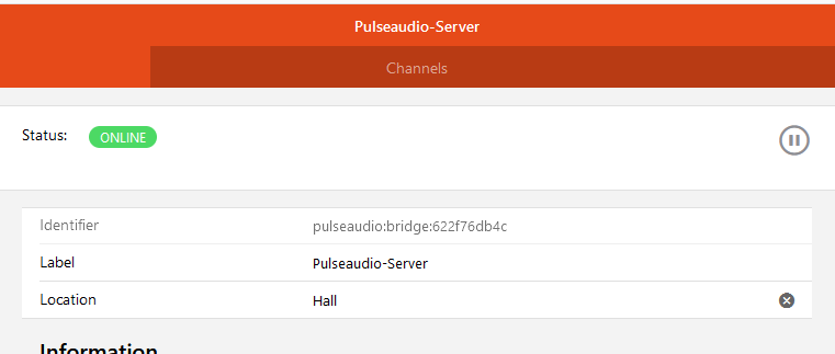

Hey Gwen,
The bridge “appears” well connected, look below. But…

Yes, this is what I said :
The bridge says ONLINE. But in order to announce “ONLINE”, it just has to be “TCP connected” to a socket. It doesn’t matter what process is listening on the other side. It will tell ONLINE but it won’t be OK.
I think that your pulseaudio NATIVE module (or another process) is listening on port 4712, the port openhab is trying to connect to (or whatever port is set in the “Port” parameter of the openhab bridge thing)
But the openhab pulseaudio binding needs to connect to the CLI module. Not NATIVE.
I suggest that you unload and reload modules by command line, and that you force port :

Sharing what Gwen shared with me earlier…
  • Install this test release for the pulse audio binding OR wait for the official openhab 3.1.0 release and install the binding normally. Disclaimer : this is a test release, and I didn’t have any feedback from other tester. It works for me :wink:
  • As per the documentation is saying, you need a running pulseaudio server with the module module-cli-protocol-tcp loaded. This is where you want the sound to be played. You DON’T NEED to have pulse audio on the openhab machine. In fact, your openhab instance could even be on a Windows machine.
    In my case, my openhab is a PC server and I play sound on a raspberry pi over the network.
  • Create a pulse audio bridge for openhab to connect to your pulse audio server (see documentation)
  • Create or use the auto detection feature to add an “audio sink” thing (see documentation)
    Activate the functionnality “Create an Audio Sink with simple-protocol-tcp” in the newly create thing configuration
  • Use the openhab play sound functionnality. You should be able to choose the pulse audio sink as a destination.
