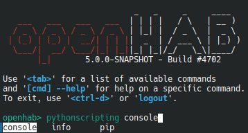

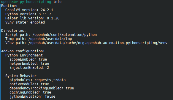

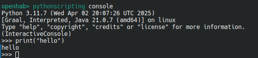

If someone wants to test a new ā€œpreviewā€ version for openhab 5.x.
The new version comes with the following new features.
  1. Support for venv setups
  2. Support for ā€˜pip’ and preinstalled ā€œmodulesā€
  3. Support for native modules
  4. OSGI Console support
    4.1. You can show python scripting state values
    4.2. You can open an interactive console
    4.3. You can install, check, list and uninstall additional modules
Here is the download link
How to activate venv is described here
This version will NOT be part of openhab 5.0. It will be merged later as part of openhab 5.1
available pip commands
