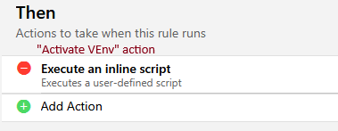

Will it be possible in the future to setup several VEnvs inside a rule without logging into openHAB console? How can I decide which rule is using what VEnv?
This is currently not possible. But graalpy team will release in ~2 month a major update with a huge improved venv handling. Let’s see, what this means.
I think that several VEnvs can be created like this. At the moment this needs to be done at the console.
graalpy -m venv <venv-dir>
Then we actually only need a way to activate the VEnv before the Python Rule is executed.
source <venv-dir>/bin/activate
Could something like a VEnv action in the Rule be introduced which selects the VEnv before “Execute an inline script” is executed.
I think that might be problematic, because I don’t think there’s a way to control the order in which Actions are executed. I.e., they aren’t supposed to rely on each other, but be independent, so there is no defined order. The Actions will run in serial (thus wait for each other to complete), and they will most likely be run in the same order each time, but you won’t control the order, so the “VEnv” activation might run after the Python script.
The order would depend on how the “parser” that inserts the rule in OH Core works, for a managed rule that would probably be ManagedRuleProvider. Even if you found a way to make sure it ran in a specific order for ManagedRuleProvider, it could change if another provider was used.
If the Actions were sorted by e.g Action ID before being executed, the order could easily be controlled by changing the IDs, but that would require a change in the above code in Core.
This was just a comment to the concept of using one Action to prepare for another. I have no idea if using an Action to set up a VEnv is viable.
Thanks for the information! Then maybe something like a Rule Metadata similar what we have for Item Metadata would be a better approach. If a VEnv Metadata with a certain VEnv is defined then it will activate this VEnv before the script is executed.
This could be a solution, but it is touching more the core part of openHAB.
From the pythonscripting perspective, I want to wait until the new major update of graalpy. Before I don’t want to spent more time into this topic. Otherwise we implement solutions which may be obsolete with the new way of handling venv. They announced to me that a lot of things will change in this direction.
