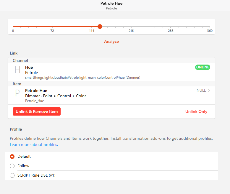

I was able to create a dimmer that goes from 0 to 360 settings the maxValue on the StateDescriptionFragmentBuilder.

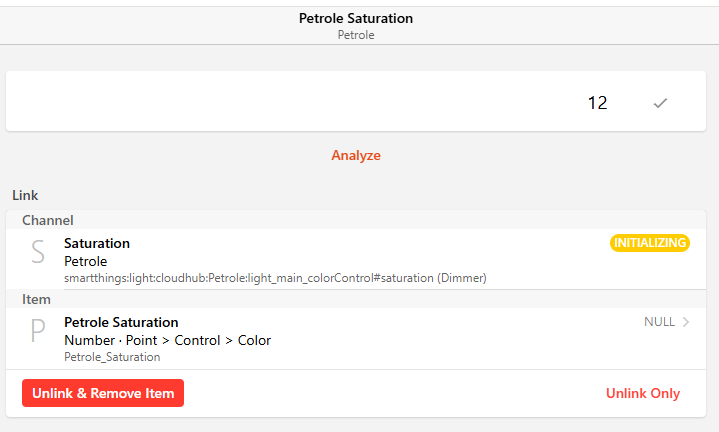

But if I do so, the Item display a InputBox instead of the Slider.
