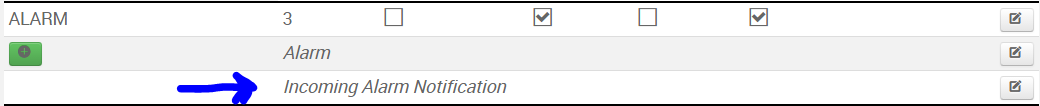

sorry no right for me to remove ALARM from:
http://www.cd-jackson.com/index.php/zwave/zwave-device-database/zwave-device-list/devicesummary/129
and for
http://www.cd-jackson.com/index.php/zwave/zwave-device-database/zwave-device-list/devicesummary/130
I could only ā€œblankā€ it if that helps
