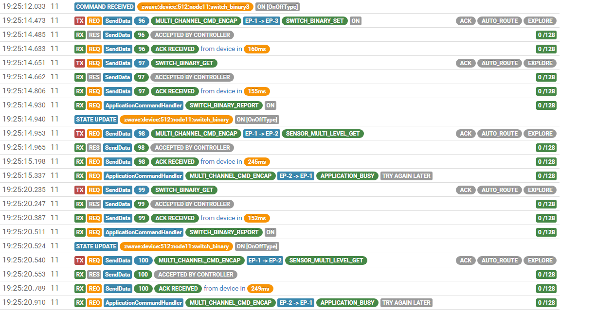

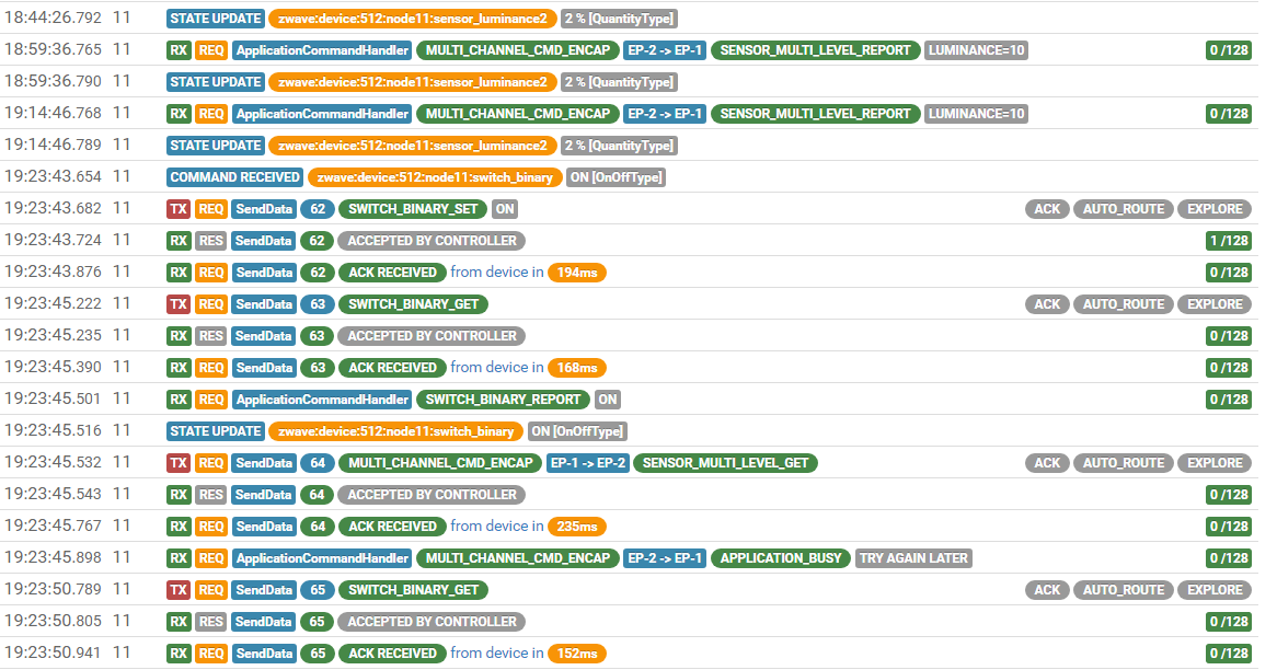

Wouldnt that then mean, that while the light sensor reporting seem to work fine (as is also the motion sensor reports) it seems that when the binary_switch and binary_switch3 is triggered, it requests a light sensor reading - which is then “application busy” ? - or am I reading the log wrong. Something seems to be wrong at least

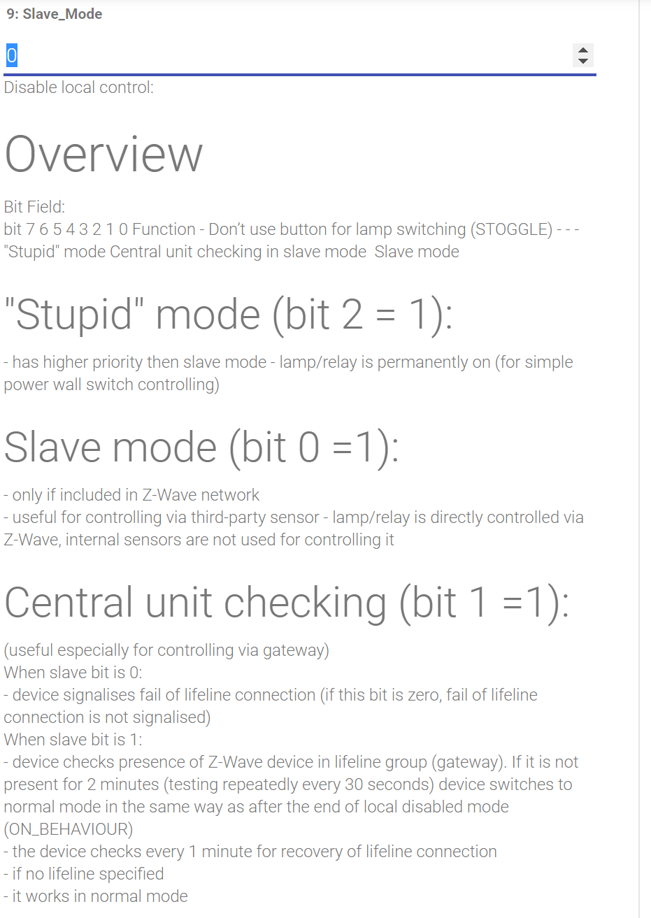

I am too stupid to know what I have to set it to (0-4) because I want “Slave mode (bit 0 =1)”.
This “trick” only works if a bitmask is involved. In this case there is no bitmask restriction and you already should be able to set each bit individually.
From right to left each bit doubles its decimal value, starting with 1 for bit 0. So if you want to set bit 2 to 1 you need to put a decimal 4 in your configuration.

I only have the choice between 0,1,2,3,4 in the PaperUI, so I set it to 1, that should result in
bit 0 = 1
bit 1 = 0
bit 2 = 0
and that equals 1x2^0 + 0x2^1 + 0x2^2 . seems to work.
