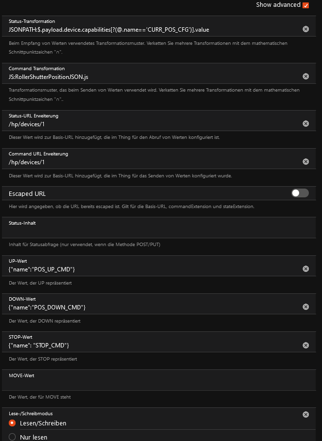

I’m using the Homepilot Premium Gateway. It seems that this Gateway has a different API. Here’s an example from a rollershutter with:
I changed the transfrom to:
(function(position){
    try{
	if (parseInt(position) != position)
	    return position;
	var obj = {name: "GOTO_POS_CMD", value: parseInt(position)};
	return (JSON.stringify(obj));
    } catch(e) {
	return null;
})(input)
Now I can have only a single item for a rollershutter that accepts UP/DOWN/STOP and an integer.
To get the IDs of your device curl http://<ip>/hp/devices | jq
