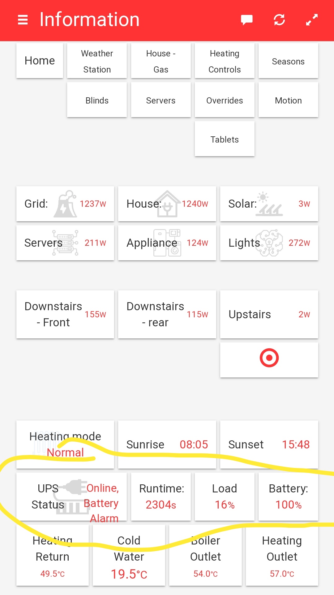

Get a l APC ups from amazon (other retailers exist too)
Get one which has USB so you can install nut on it. When the ups is running low, nut can gracefully shutdown your pi.
https://www.amazon.co.uk/APC-Back-UPS-BX-Uninterruptible-Shutdown/dp/B00T7BYV6W/
The non-USB one is half the price but really, you’re only delaying the inevitable unclean shutdown with that.
Actually I liked the apcupsd? software better than nut.
apcupsd
nut is a lot more complex, would be nice to have a simple solution, but on the other hand, there is a full-featured NUTv2 Binding in openHAB
