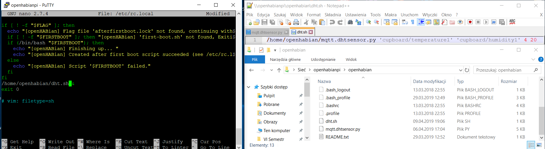

I have problem when I’m trying to start the dht.sh script at boot. It looks like dht.sh is not being opened at the boot. Nothing is being sent by MQTT.
When I type /home/openhabian/dht.sh by myself it works fine.
Try this: Solved: Starting programs at boot didn’t work on raspberry – Arduino, ESP8266, ESP32 & Raspberry Pi stuff
