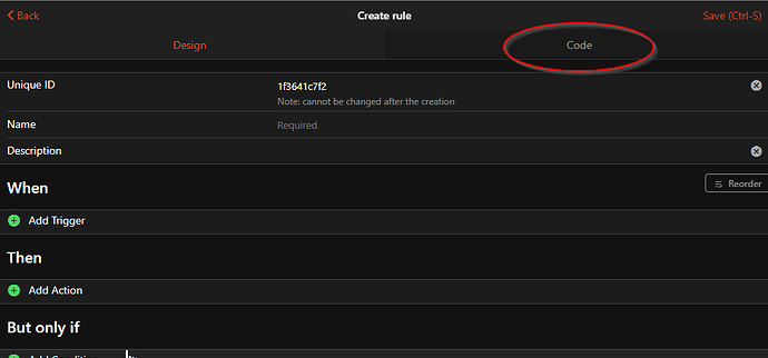

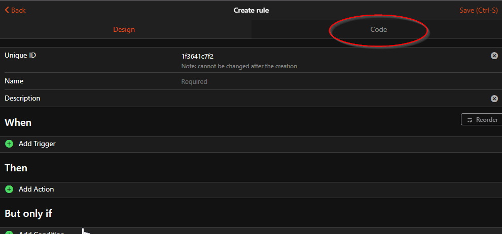

Executing this script in the UI gives me this. Can you see why?
2022-01-10 19:38:46.950 [ERROR] [b.automation.script.javascript.stack] - Failed to execute script:
org.graalvm.polyglot.PolyglotException: SyntaxError: <eval>:5:10 Expected ; but found :
  - inputs: {}
<eval>:9:14 Expected an operand but found >
      script: >
	at org.graalvm.polyglot.Context.eval(Context.java:379) ~[?:?]
	at com.oracle.truffle.js.scriptengine.GraalJSScriptEngine.eval(GraalJSScriptEngine.java:458) ~[?:?]
	at com.oracle.truffle.js.scriptengine.GraalJSScriptEngine.eval(GraalJSScriptEngine.java:426) ~[?:?]
	at javax.script.AbstractScriptEngine.eval(AbstractScriptEngine.java:264) ~[java.scripting:?]
	at org.openhab.automation.jsscripting.internal.scriptengine.DelegatingScriptEngineWithInvocable.eval(DelegatingScriptEngineWithInvocable.java:51) ~[?:?]
	at org.openhab.automation.jsscripting.internal.scriptengine.InvocationInterceptingScriptEngineWithInvocable.eval(InvocationInterceptingScriptEngineWithInvocable.java:69) ~[?:?]
	at org.openhab.core.automation.module.script.internal.handler.ScriptActionHandler.lambda$0(ScriptActionHandler.java:62) ~[?:?]
	at java.util.Optional.ifPresent(Optional.java:183) ~[?:?]
	at org.openhab.core.automation.module.script.internal.handler.ScriptActionHandler.execute(ScriptActionHandler.java:59) ~[?:?]
	at org.openhab.core.automation.internal.RuleEngineImpl.executeActions(RuleEngineImpl.java:1180) ~[?:?]
	at org.openhab.core.automation.internal.RuleEngineImpl.runNow(RuleEngineImpl.java:1032) ~[?:?]
	at org.openhab.core.automation.internal.RuleEngineImpl.runNow(RuleEngineImpl.java:1048) ~[?:?]
	at org.openhab.core.automation.rest.internal.RuleResource.runNow(RuleResource.java:327) ~[?:?]

2022-01-10 19:38:46.985 [ERROR] [internal.handler.ScriptActionHandler] - Script execution of rule with UID 'Afval_Cyclus' failed: org.graalvm.polyglot.PolyglotException: SyntaxError: <eval>:5:10 Expected ; but found :
  - inputs: null
      script: >
Did you switch to the code view first and then pasted the code?
That way you can enter a rule together with the conditions. If you just want the rule itself paste only the script part between (the part between script: > and type: script.ScriptAction
