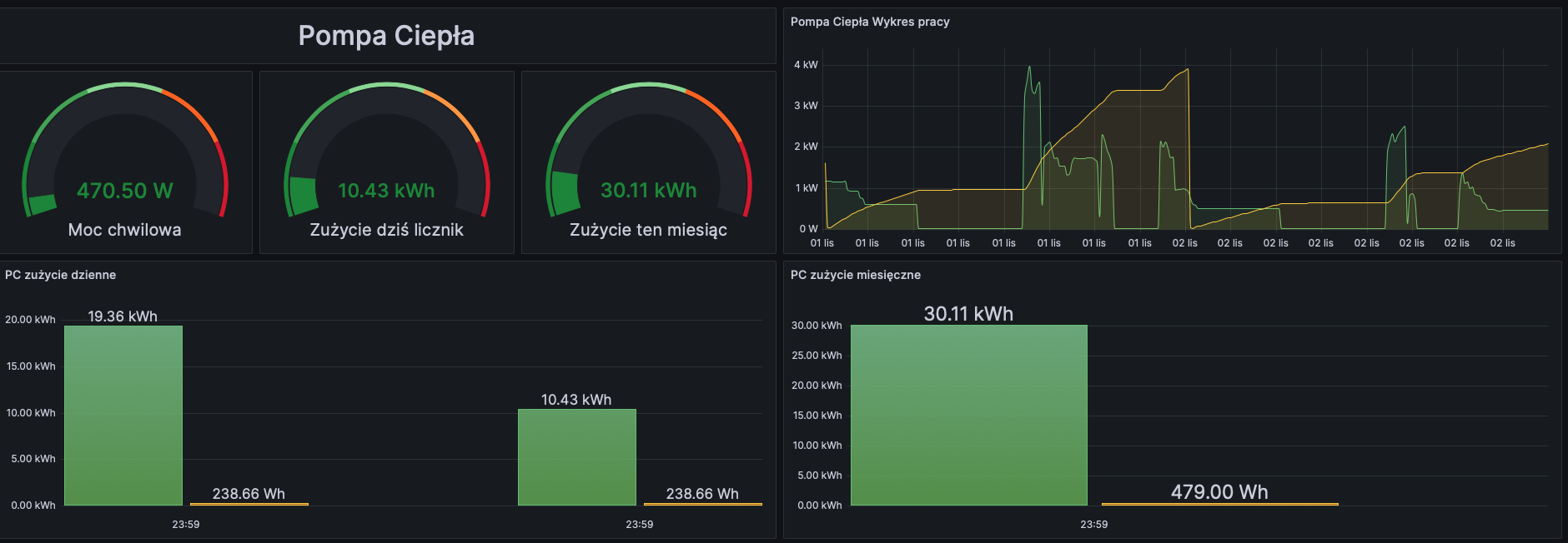

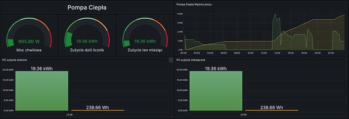

After all of this when I show this data in grafana I see that summ of values is not same as calculation from rules for this month:
First day of month is accurate:
Summ for two days and more is not accurate:
Anybody can find was cause this difference and how to fix it? Because for whole month difference is so big that it feels like one day is missing. But there isn’t.
