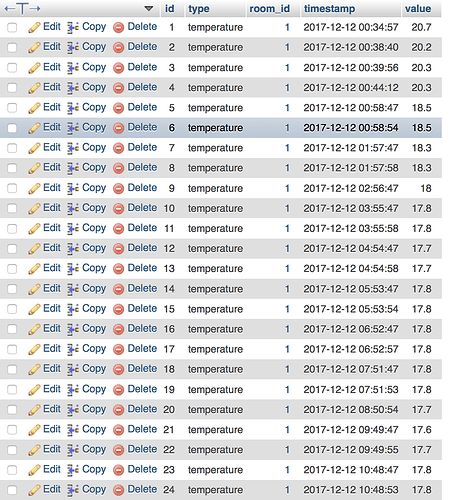

Well, rows 1-4 were manual HTTP posts to test my web server. → I should have cleared this out sooner
From row 5, I always observe 2 records on an update.
For example:
row 5: time = 00:58:47 temperature = 18.5
row 6: time = 00:58:54 temperature = 18.5
What I expected was just one row with the temperature for each update.
Like what suddenly happens with row 9 for no reason.

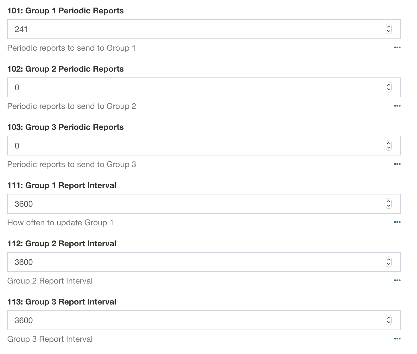

Ok, so it’s sending an unsolicited report every hour.
Is this an Aeon ZW-100?
How often does the device wake up, and what is the polling interval. You can find both those parameters in the Thing panel in HABmin (under Wakeup Configuration and Device Configuration, respectively).
No. This viewer.
http://www.cd-jackson.com/index.php/openhab/zwave-log-viewer
Yes, this is a ZW100.
Wakeup interval: 3600
Report interval Group 1: 3600
Polling period: 30 min
Which file should I add? Excuse me for these probably frequently asked questions. I really appreciate the help!
So, I would expect you would get another temp report every hour when the device wakes up. For background, the binding puts a request on the queue for all the device’s (linked) channels every 30 minutes. If a poll message is already on the queue, it doesn’t add another poll message to the queue. When the device wakes up, the queued messages are sent to the device.
