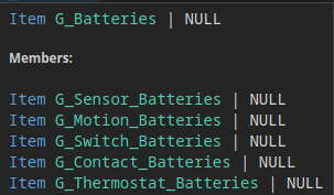

The rule goes through included groups in a master group. Example for Batteries group :
///////////////////////////// Niveaux batteries /////////////////////////////////
Group G_Batteries "Etat batteries" <battery>
Group G_Sensor_Batteries "Batteries capteurs" <battery> (G_Batteries)
Group G_Contact_Batteries "Batteries contacts" <battery> (G_Batteries)
Group G_Motion_Batteries "Batteries motion sensors" <battery> (G_Batteries)
Group G_Switch_Batteries "Batteries switches" <battery> (G_Batteries)
Group G_Thermostat_Batteries "Batteries thermostats" <battery> (G_Batteries)
