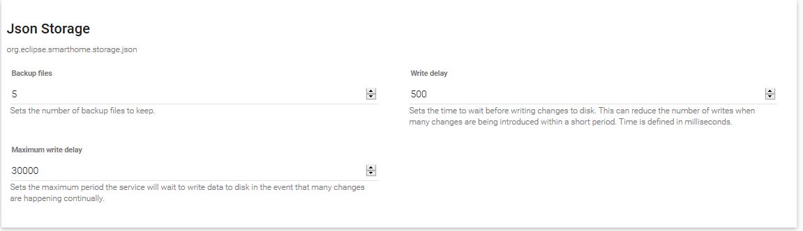

Third, backup us a real issue for me, because in my trail phase I sometime crashes my Pi or I want to go back to a previous state.
Now, as I understand the config stuff, I can backup this, but what about the PaperUI detected stuff? Best for me would be a twofold approach. 1. an export/import function for the PaperUI DB (its not important to get it human readable/editable but it must be restore-able) and 2. saving the text files (which is available today).
And last but not least, I really like and appreciate what you guys have done here. Now I need to go back to my system to learn more about it :slight_smile:
Thanks for reading.
It’s there, fully automatic :grinning:. You just need to copy it to another drive to be more safe:
