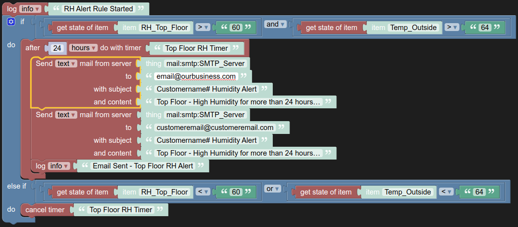

I manage a number of system that we use for monitoring and automation. For the monitoring, I have rules with email and/or text alerts which I have created using Blockly. I am interested to know if there is a way for all of these rules to reference an email address (in the “to” block), and a house name (in the “with subject” block) so I don’t have to go enter these in each alert rule manually when I build these systems.
Here is what the blocks look like:
You have two options.
  1. Put them into Items.
  2. Put them into the shared cache
The advantage of putting them into Items is the Item can be modified from the UI and gets restored on startup if configured. For 2 you’ll need a system startup rule that restores them to cache.
Option 3)
Create a dedicated script only for sending the message. From the rule you only call the script with the necessary parameters and have everything else configured within the script itself
Option 4)
Create your own blockly

rikoshak despite your very detailed instructions (thanks!) I was still having problems getting it working. But the part about being able to reference an Item label gave me the idea to just create an email address item with the actual email address as the label. Then I use the blockly script to call that Item. This is super simple and seems to work. Is there some reason I shouldn’t use this way of doing this?
It’s a little odd but not terrible. But if you can get the label I don’t understand why you can’t get the state. It’s the exact same block, just select “state” instead of “label”.
The biggest limitation is that end users won’t be able to change the email address. Only admin users can change the label of an Item. But end users can change the state of an Item.
