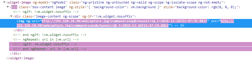

The html code generated by habpanel is very different:
without “no chache”:
the pink lines are periodically refreshed.

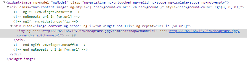

with “no chache”
no refresh at all
