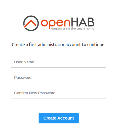

I just started up an instance of OH in Docker using the command listed in the docs and empty volumes mounted to conf and userdata. I got the new user form as expected.
