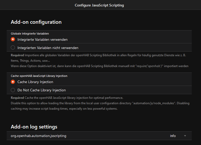

I use the integrated js lib:
Maybe a change in the binding behind this item ?
