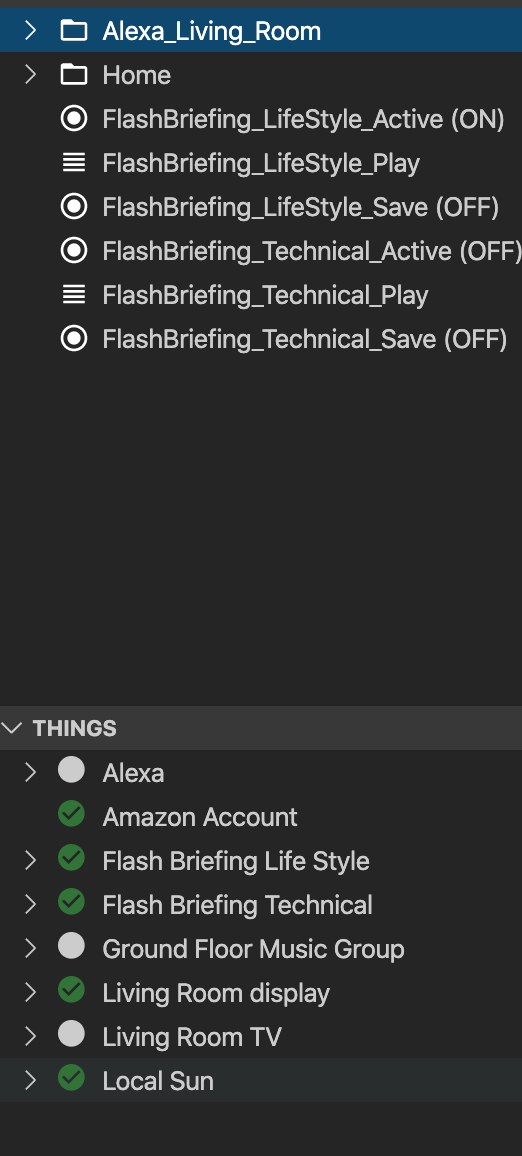

I am trying to configure the echo dot. I have amazon echo account configured. Through paper UI if I switch on the flash briefing and select the echo device it starts playing. However, there is a weird behaviour in terms of items and sitemap. I have never been able to get it working. Also my echo device does not show online at all below is the snapshot, before this my thing configuration
