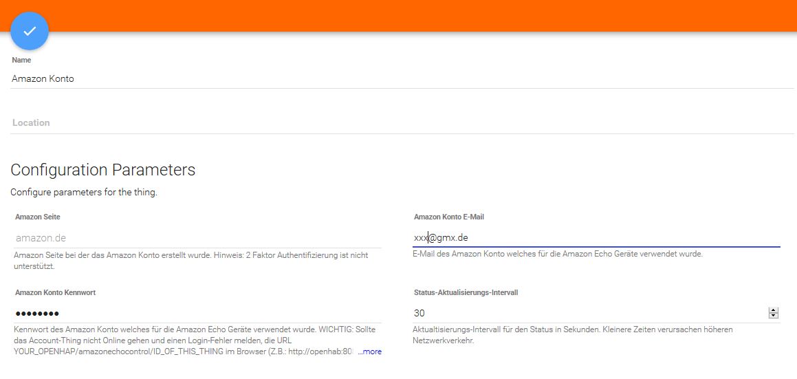

But I’ve got a problem. I’m not able to connect to my Amazon Account (.de). When I open /amazonechocontrol, I get an error 500 with the following message:
org.openhab.binding.amazonechocontrol.internal.ConnectionException: No session id received

Did you provide your credentials for your Amazon account?
Yes. I also double checked the credentials, they are correct.

did you try to enter your crendentials using http://YOUR_OPENHAP/amazonechocontrol/ID_OF_THIS_THING i needed to do this on debian because otherwise it wouldn’t connect for me too

thanks for your reply. I can access this link, but I’m not able to enter any credentials. The error above (No session id received) is shown on that page.

just a guess, do you have the binding installed in your addon folder as well as using paperUI?
also did you already tried deleting the cache?
is there a specific reason you are still running OH 2.3 RC1? if not updating to openHAB 2.3.0-1 (Release Build) might be worth a try
Yes, i put the file in the addon folder during troubleshooting. Not sure if the message started at that point.
But clearing the cache did the job! Now everything is working fine.
Thank you very much. You made my day! :slight_smile:
