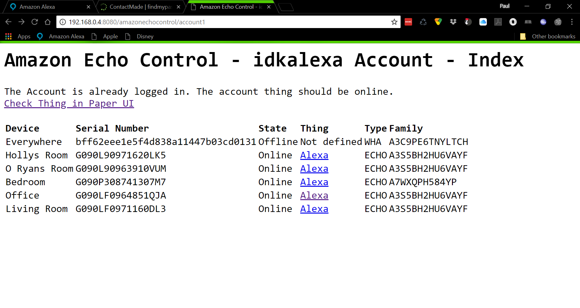

I’m only using snapshots. I’ll see if I can recreate this one. However, I get the No session ID received error and a 500 from http://openhab:8080/amazonechocontrol/. It went away once after waiting about 5 hours, but came back after a restart.
Could you please clarify if step 3b needs to be done from the OH server? I’m currently running headless and get the same 500 error when I try from my laptop.
@cadburesI have checked the rules with grep and there is only two rules tjhat have ‘_Volume’ and neither is for BR3_Echo_Volume. And in each case it was a sendCommand to make a device bneep not as a trigger condition.
any other ideas? what’s the karaf command to debug this addon? Perhaps debug will shed further light.

It can be done from everywhere, the calls to the amazon server are always done from the OH machine

Could this be causing me an issue?
I have the following in the log:
2018-06-20 18:39:22.888 [hingStatusInfoChangedEvent] - 'amazonechocontrol:account:account1' changed from OFFLINE (CONFIGURATION_ERROR): Login fails. Check your credentials and try to login with your webbrowser to http(s)://<youropenhab:yourport>/amazonechocontrol/account1
Important Message! To better protect your account, please re-enter your password and then enter the characters as they are shown in the image below. to ONLINE
And yet going to PaperUI the account and all defined things are ONLINE and the Web page it requests you to look at says this?
[EDIT] Upon further investigation going into paperui directly I could see that the account and all the echo units were showing as offline, reentered the password and they all came back online.
