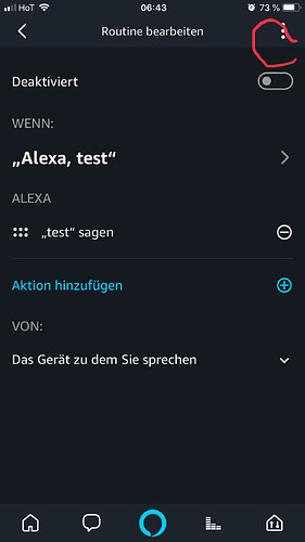

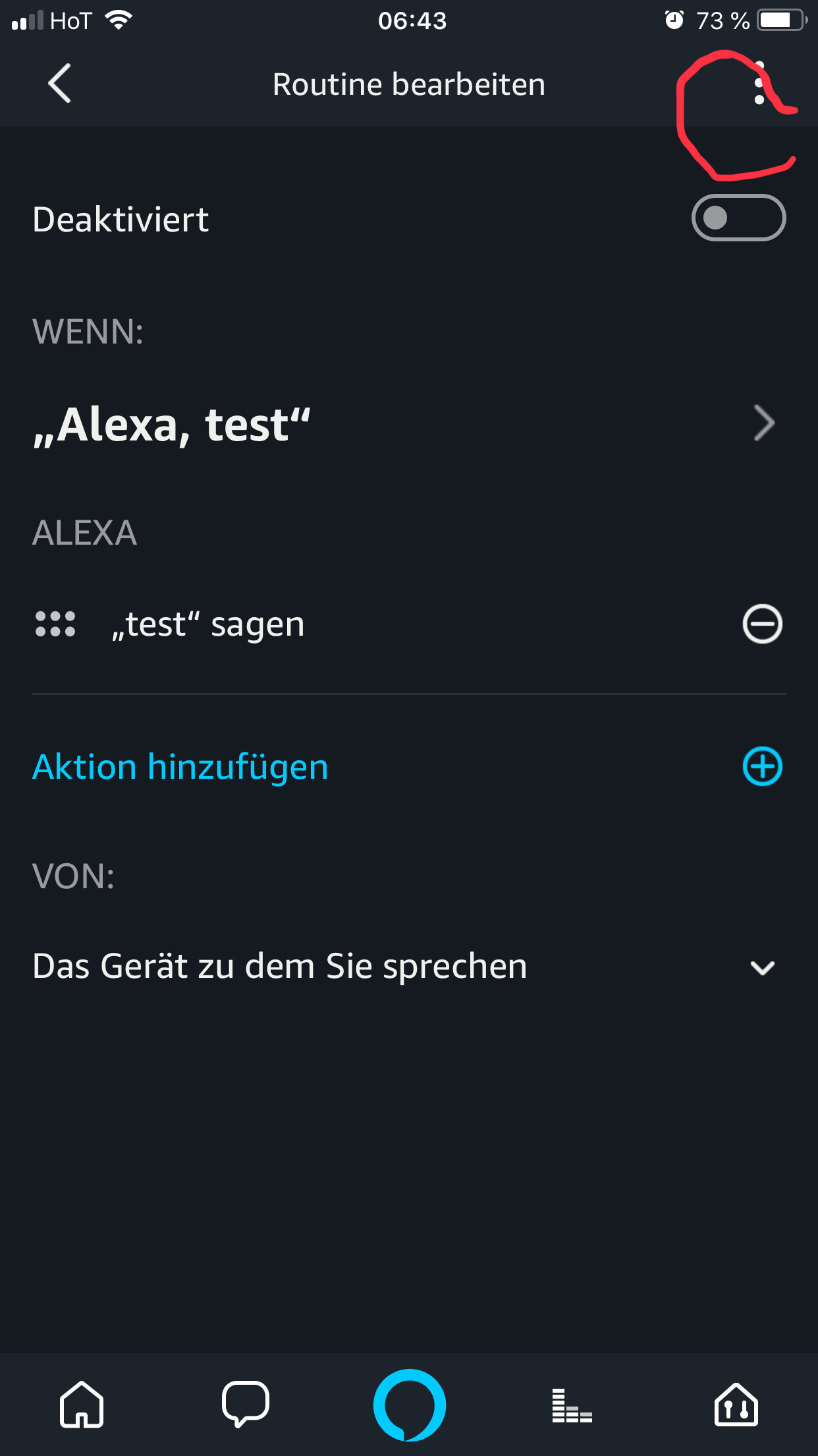

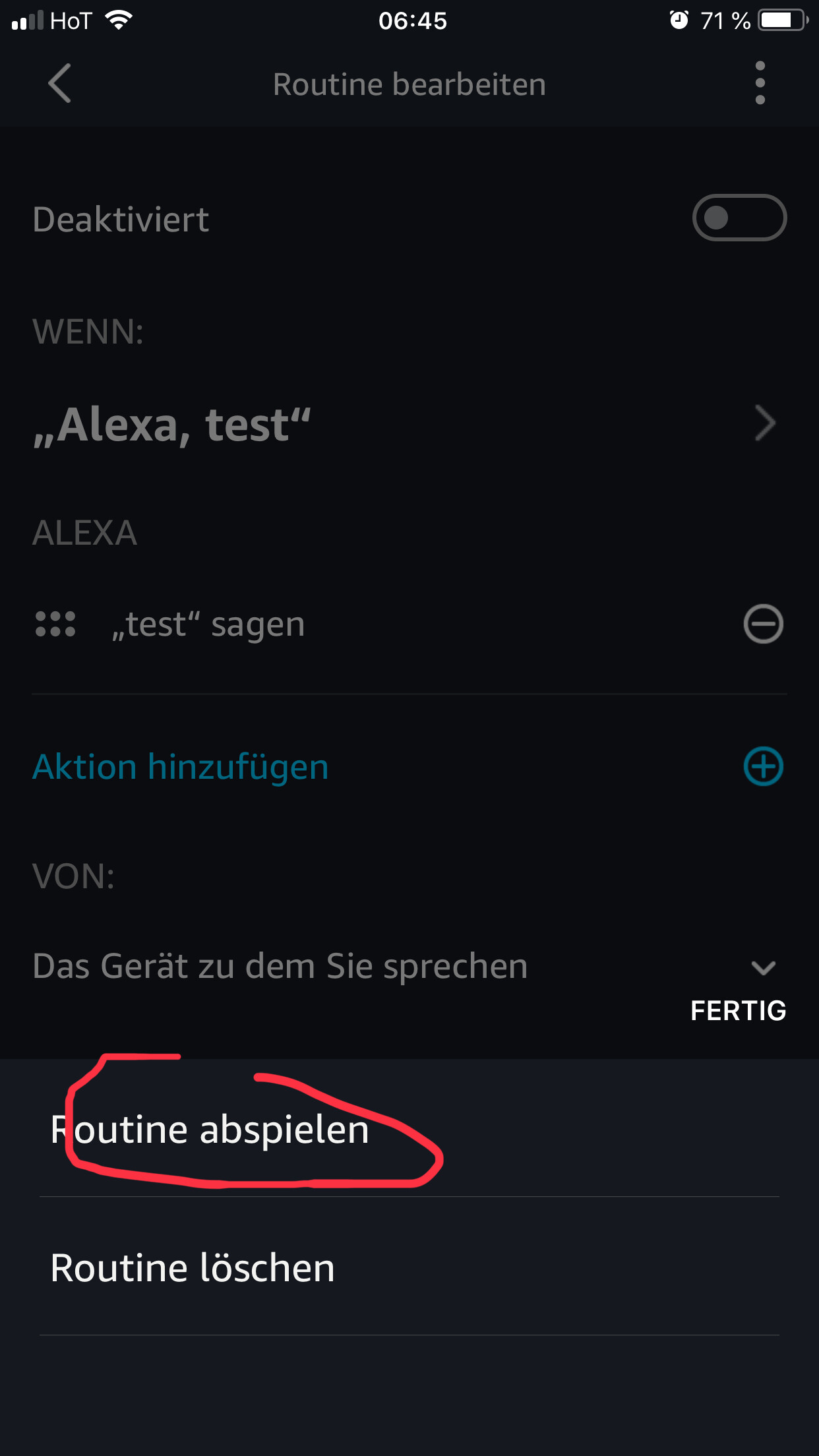

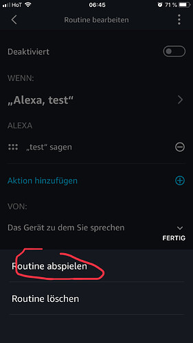

Hi Mr. Wiseman,
sorry for my not matching instructions.
  1. Create a routine (e.g. Alexa Says, select any text or enter your own)
  2. Click on the 3 dots
  3. Click on ‘Play routine’
  4. Select your device
Thank you for testing!
Best regards,
Michael
Confirmed DNS issue - sorry for the red herring
Hey Michael,
It worked . . .
Created a routine “Alexa, test routine” which Alexa will “Tell you something New” and then I followed your instructions and it played on the Echo Dot w/o any issues.
