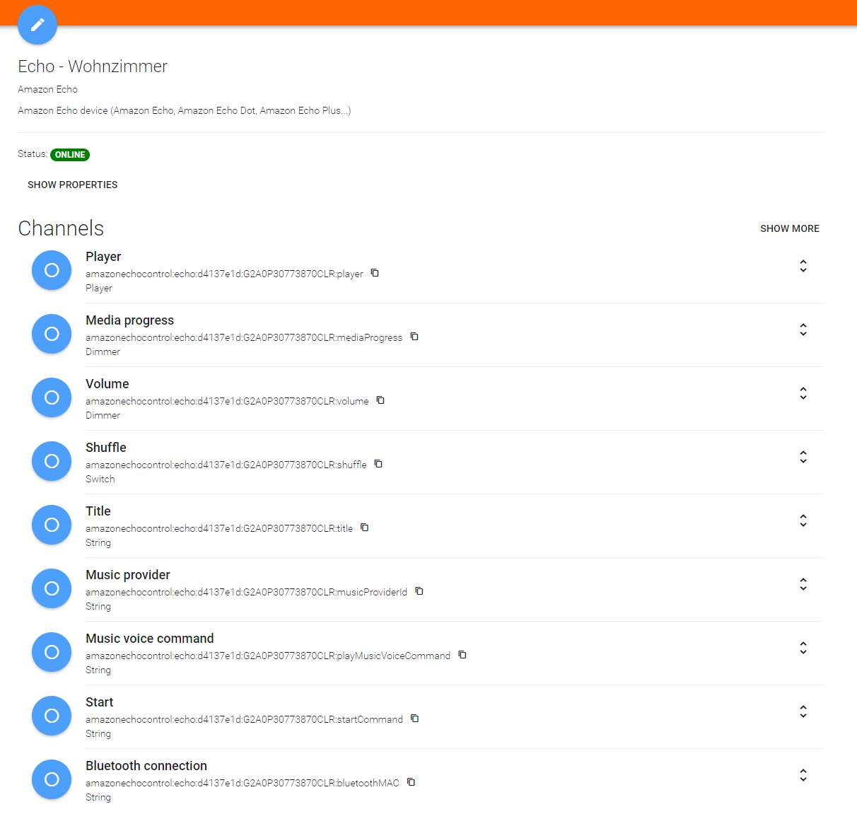

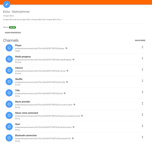

As I read here, some of you also encoutered the problem of the TTS-Channel not showing up.
I readded the devices and they also show up, but the TTS-Channel is missing on all of them (6 Echos in my account).
Is there any idea what I can do to get the channel or did I miss a step?
Thanks! :slight_smile:
@Patrick_S Click on the show more button on the right side of the page.
This is pretty embarrassing…
Thanks for the quick answer, it got “fixed” :smiley:
