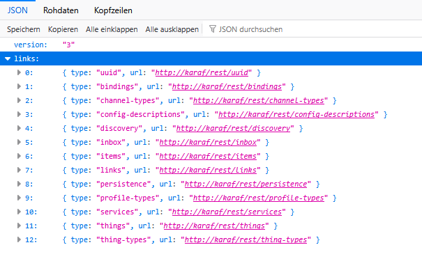

The two URLs suggested by @rlkoshak boeth lead to the same UI as just http://<ip of SMF> :frowning:
The only thing that leads to something else is http://<ip of SMF>/rest/
Unfortunatelly I am way to unexperienced to know how I could integrate these information (especially the ones in “items”) into openHAB.
Does anybody have an idea about that? Just integrating the information out of the JSON structure via HTTP request or something like that?

This is the example resonse for a wallbox-related endpoint, the “readonly: false” part sounds as if there would be an option to also change settings via REST. Would that have to happen via a POST request to the “items” endpoints, or would that work via a “bindings” endpoints? (I didn’t have the chance yet to check if the “bindings” endpoints are available or blocked though)
link “``http://karaf/rest/items/foxessevcharger_wallbox_xxxxxxxxxxxxxx_switchable_switchThing_P_active”
