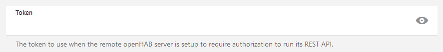

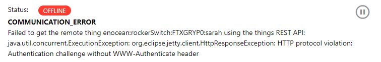

With a remote OH3 server, you need to create an API token in your remote server using MainUI and then provide this token as setting to your remote server thing in your main server. It will allow running actions rrequiring authentication like getting your remote things.
Here is the setting to set in the binding:
Thank you! Now it works.

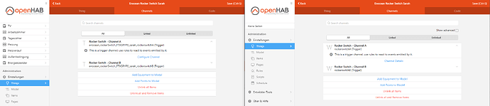

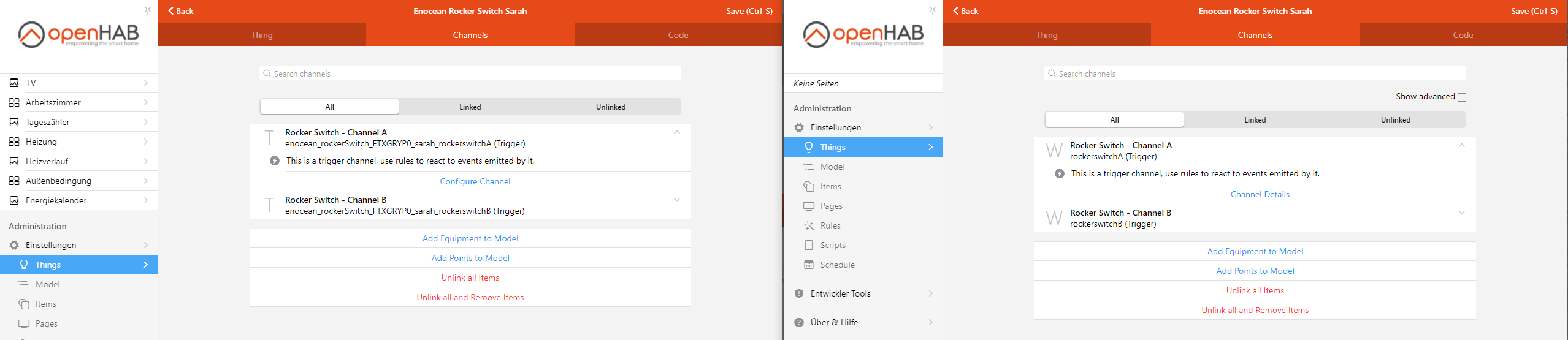

The enocean-rocker-switch-thing is shared and seems online in both machines.
But the trigger events are only available on the machine where the physical stick is installed:

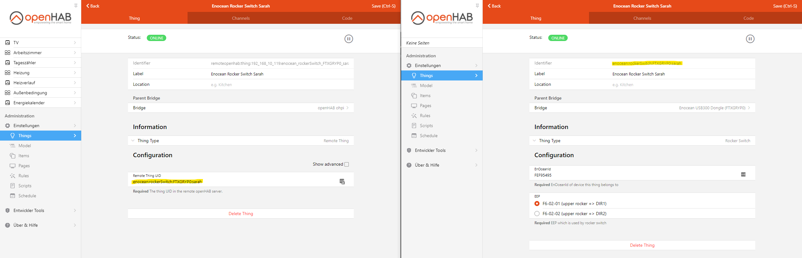

Did you add the corresponding remote thing on your main server ? Do you see the trigger channel on this thing in MainUI on your main server ? Did you create a rule based on the local trigger channel in your main server ?
If the answers are true to these three questions, please show:
your thing with its trigger channel in your main server
your rule with the trigger in your main server
enable the TRACE logs of the binding and show how they look when your remote trigger channel enocean:rockerSwitch:FTXGRYP0:sarah:rockerswitchA is triggered.

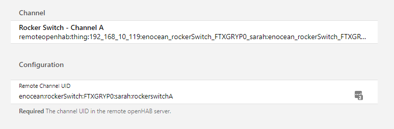

And you used remoteopenhab:thing:192_168_10_119:enocean_rockerSwitch_FTXGRYP0_sarah:enocean_rockerSwitch_FTXGRYP0_sarah_rockerswitchA as channel trigger for your rule ?
