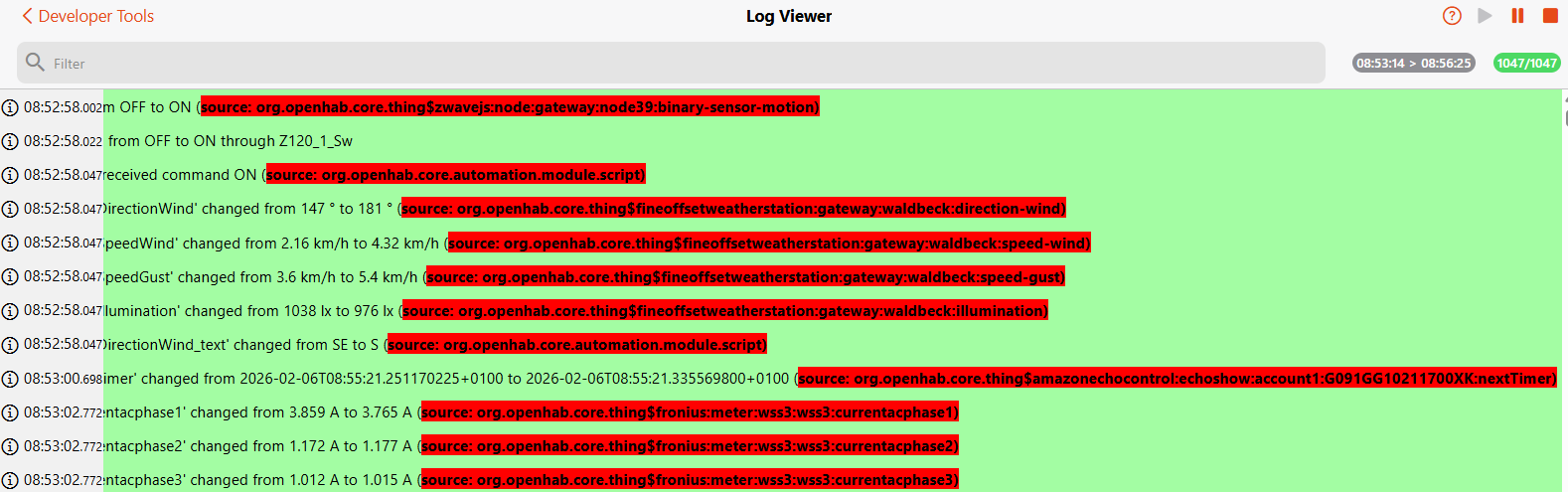

This is getting hard to read. Was there a way to apply some coloring in the log, so eyes focus on the important stuff?
In the log reader under Developer Tools? You’ll need to open an issue to request that but it should be possible to add that.
Anywhere else you’ll need to look into how that tool does coordinating and configure it as appropriate. The logger itself doesn’t do any color coding. That’s all implemented by what ever you are using to view the logs.

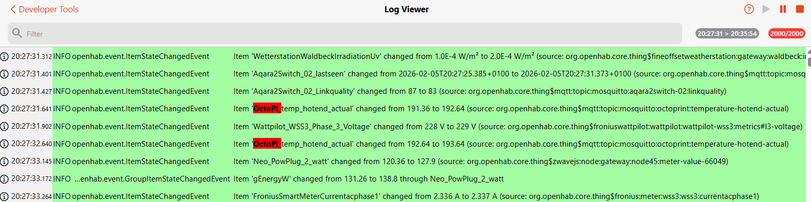

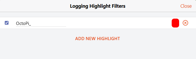

I think it is already there:
On the bottom of the log viewer, click “Configure highlights”, then for example:

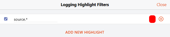

I don’t think that’s what @agrarina is asking for. I understand them to be asking to highlight the whole “(source:…)” part of the line in a different color.
Does the highlight field accept regex?
Yes:
