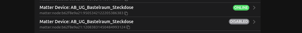

In my setup, I have several duplicate Things because I was unable to delete existing Things using Remove Thing. So far, I have only been using the UI-based configuration.
In the last case, I lost the connection to my Eve Matter device after updating to 5.2.0.M2. For this reason, I decided to create a new Eve Matter device by:
  1. I set the existing device to “Disabled”
  2. Then I executed “Remove Things.” However, this process was never successfully completed. The Thing status was hanging at Removing Thing
  3. I created a new EVE Matter device by scanning.
So I ended up with to Things of my Eve Matter Device. The actual one enabled and the old (unused one) disabled.
How can I remove a device from my installation that no longer exists?
