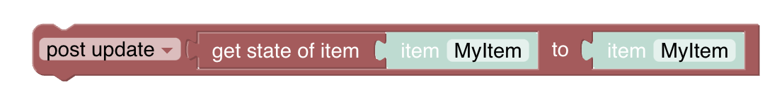

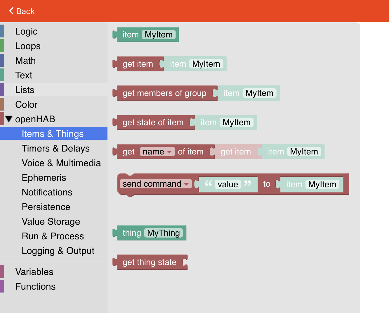

Blockly should be relatively self explanatory. It’s all graphical. You want to interact with openHAB. There’s an openHAB set of Blocks.
You want to update an Item. There’s an “Items and Things” section under openHAB.
So you want to send the state of one Item to another Item. One of the blocks gets the state of an Item. Another talks about sending a value to an Item. So use those. And since you want to update the Item, change the send command to post update.
Or, if you want to use Rules DSL and type it out in text, be sure to reference the docs. Textual Rules | openHAB
Again, you want to manipulate the state of Items. There’s a whole section for that. Textual Rules | openHAB
And one key thing to notice in the examples is that to get the state of an Item you use .state. You can’t just postUpdate a whole Item to another Item. An Item has a whole lot of other stuff associated with it too. But only the state can be sent as an update.

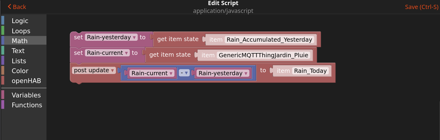

Thank you again for your detailed explanations and the screenshots. Very great help!
I went the Blockly way.
For the subtract, I had to use variables, was there a better way?

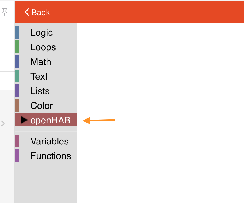

I noticed I am missing the arrow and several options under “openHAB” section. By chance, when I click on openHAB I have de “Items and Things” section.
The others depend of bindings you installed?
If it works it works. I do know there are times when you have to convert a state to a variable like that.
There have been a ton of additions to Blockly in the past weeks to make it support more openHAB features and therefore making it more suitable for rules development overall and not just useful for simple use cases.
