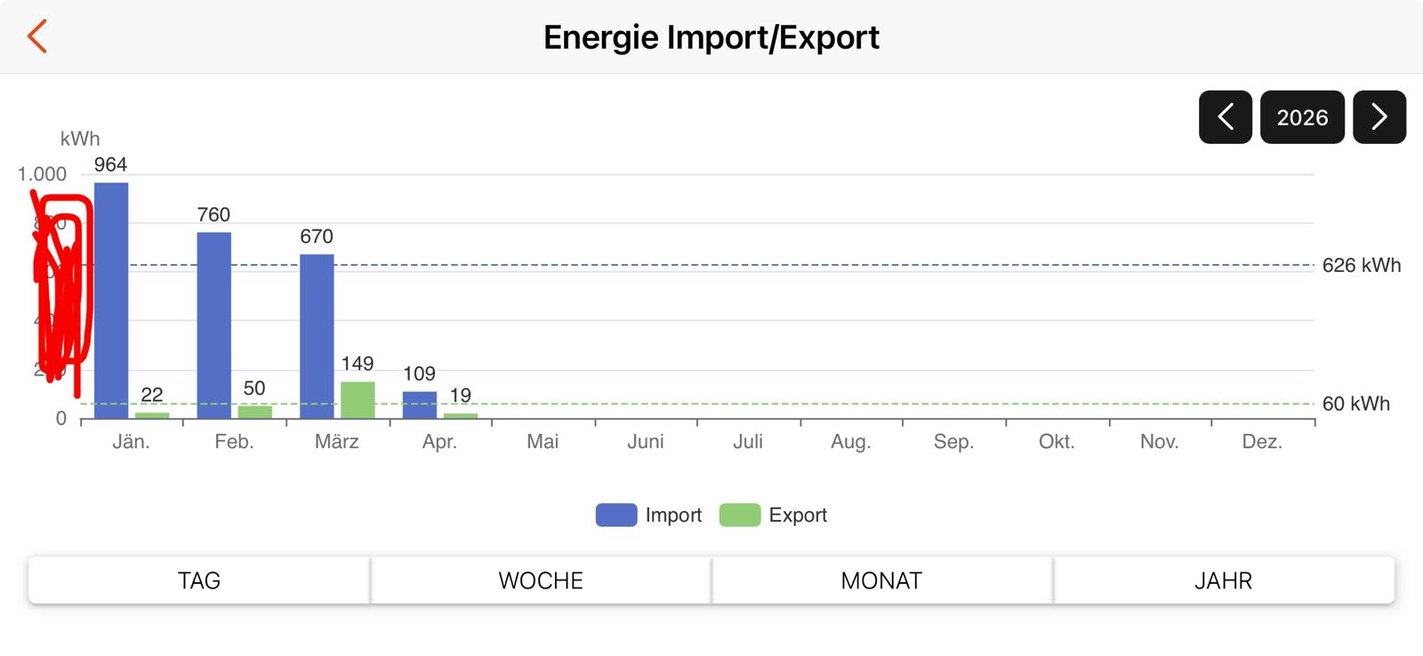

With echart it seems the safe area inset on the left side does not work?
iPhone 14 Pro with notch on the left in landscape mode. echart streches all the way to the left of the iPhone screen - the notch is covering most of the y-axis. I could push in the y-axis a bit more, but that would also impact other devices with no notch.

Any chance to automatically push in the y-axis for devices with notch such as the iPhone?

Well, I tried just a minute ago.
Unfortunately, putting height and width under style doesn’t work - the notch still overlays the chart.
This works for height, but not for width:
This neither works for height nor for width:
Could this be a bug or is it just a special case with oh-chart/echart?

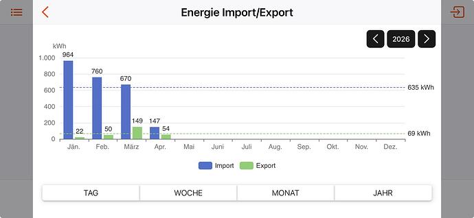

With these setting, I get a fullscreen popup with safe areas left and right on the iPhone for the notch:

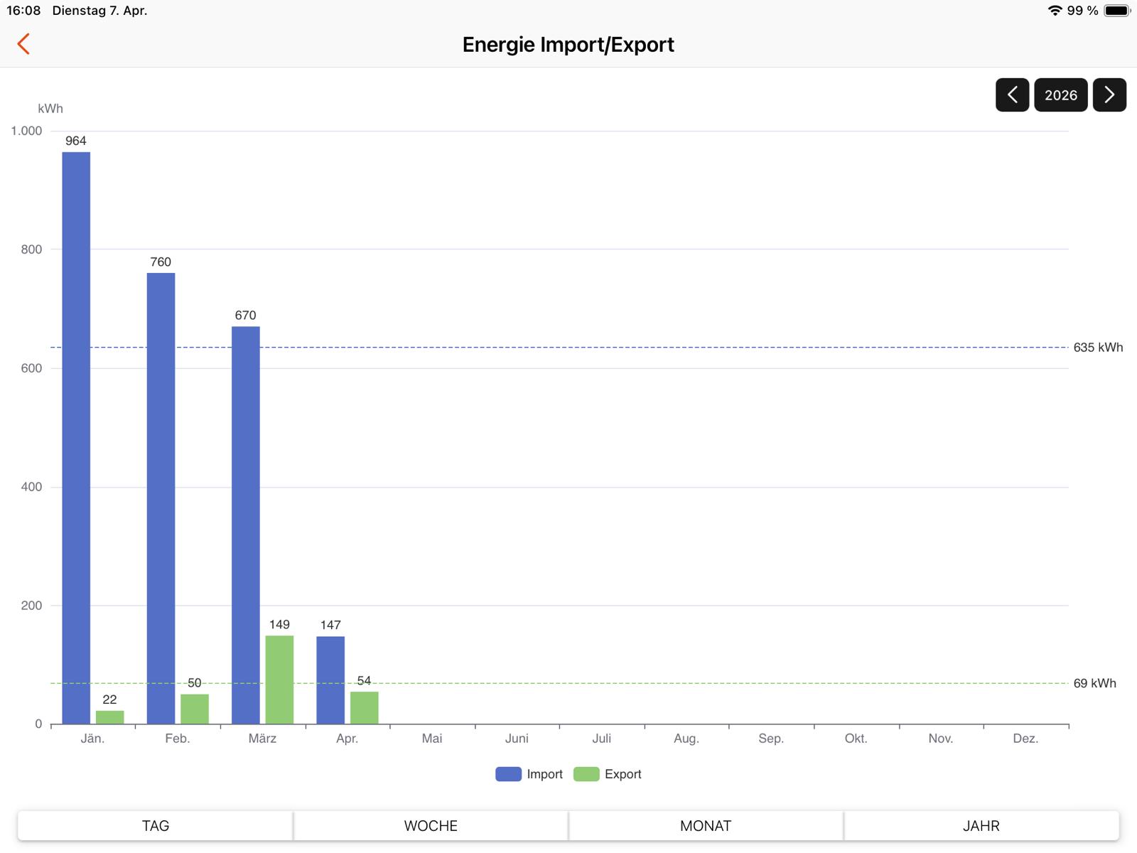

… and no safe areas on e.g. iPad:
