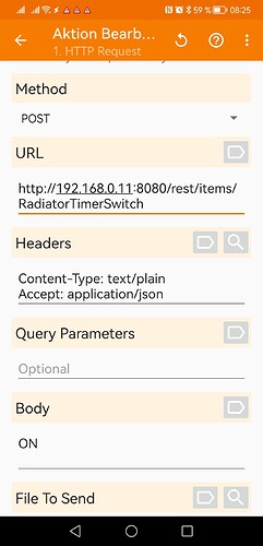

I am invoking the REST API on my old Openhab 2 server from Tasker like this:
Works like a charm
Doing the same on my new Openhab 3 server gives me error code “404” and:
However the following works from the Linux console both on the Openhab 3 server itself as well as from my Laptop:
curl -v -X POST --header "Content-Type: text/plain" --header "Accept: application/json" -d "ON" "http://{192.168.0.11}:8080/rest/items/RadiatorTimerSwitch"
Something is blocking the Tasker access…
Any idea?

I have tried that, but no change.
I have in the meantime got access to the item via myopenhab.org .
Posting an ON or OFF to the item returns success code 200, but the item state does not change.
