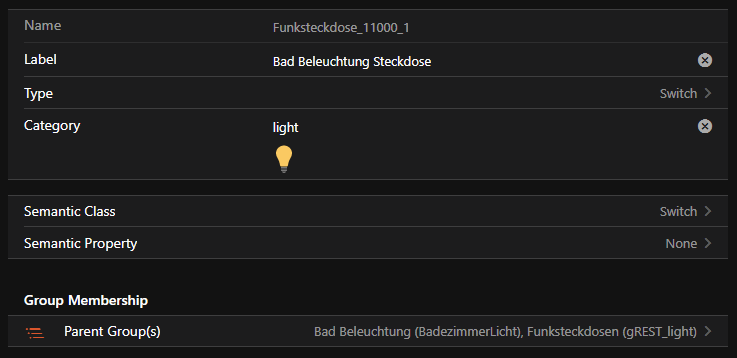

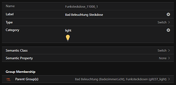

The following steps can either be done manually using the OpenHAB UI or using RESTlight.items file found below:
  • Add the RESTlight.rules rule (see below) to OpenHAB and replace the IP-Adress and API-Key with the values from your REST-light setup.
  • Add a group gREST_light to OpenHAB and add your 433Mhz Devices as Switches to this group. The Device name has to be in the format of example_<SYSTEM_CODE>_<UNIT_CODE> and is used to determine which device is controlled. The Label can then be used to add a more meaningful display-name in the UI.
