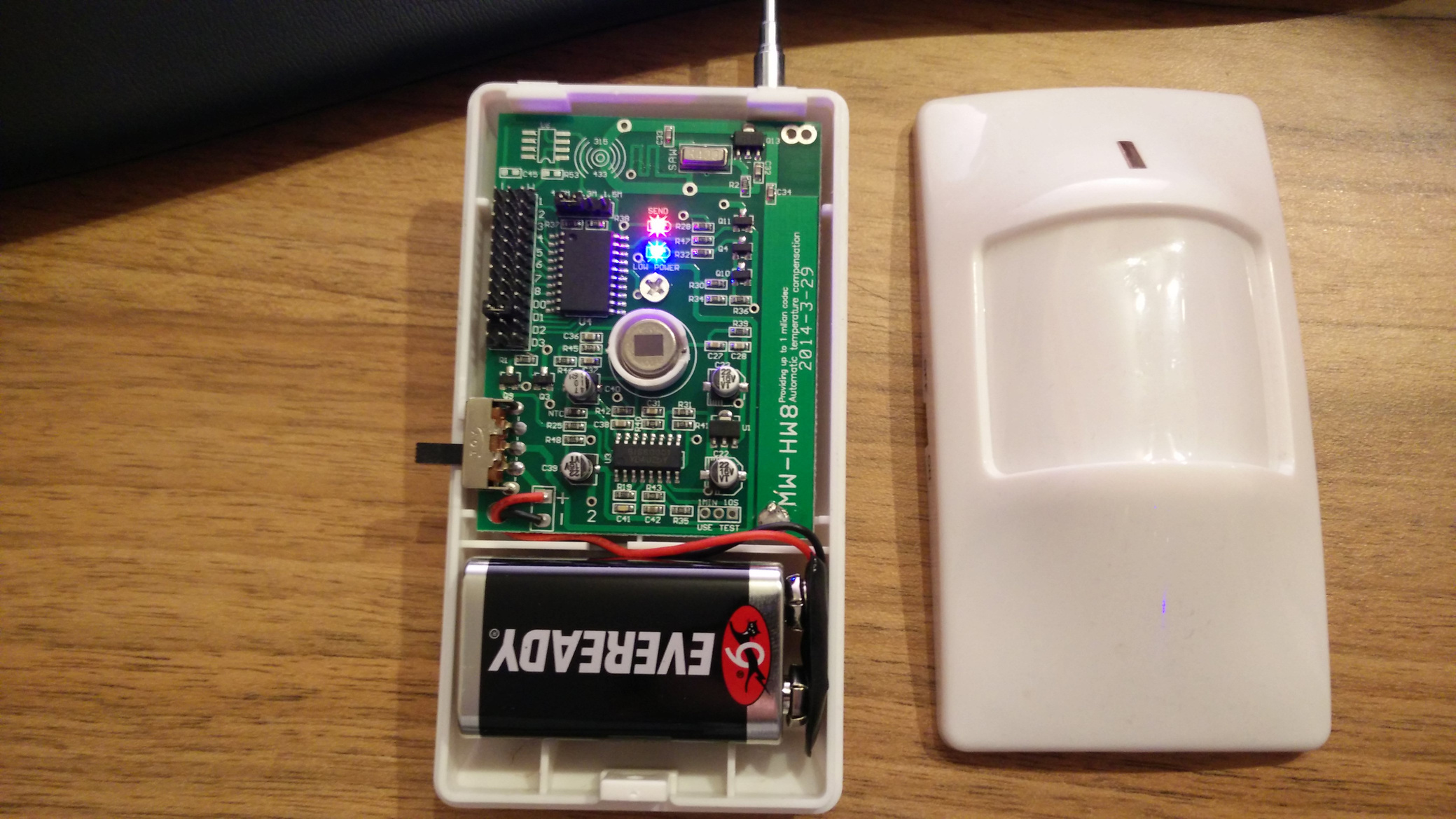

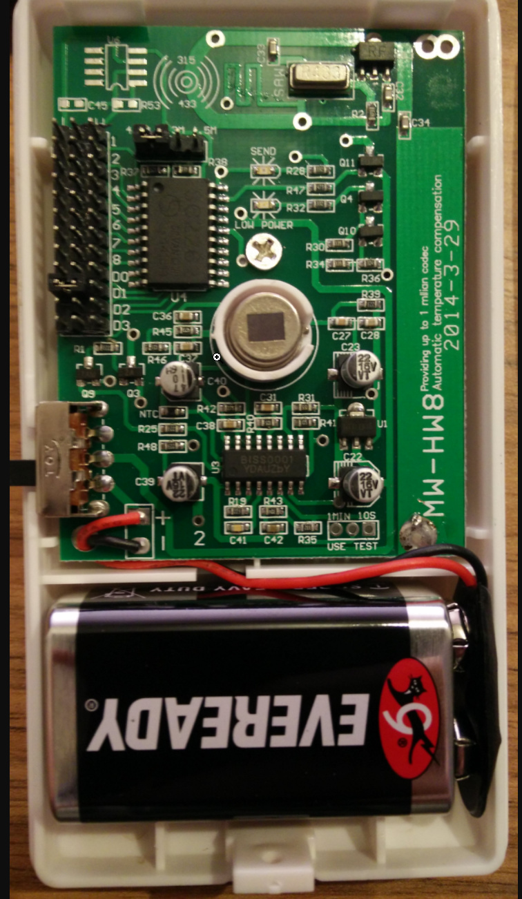

I made photos for you if you are interested in what those look like on the inside:

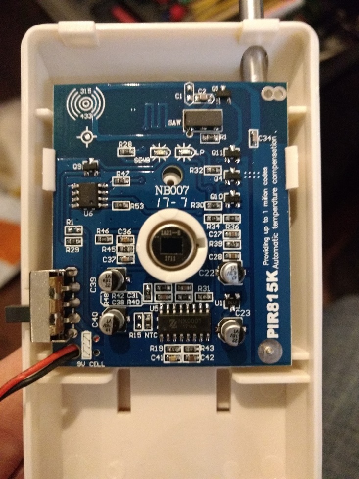

I ordered the PIR sensors - however, mine look different - any idea how to get them working?
They don’t show up in Openhab
By the looks of it with missing code switch and the text “providing up to 1 million codes” (which is not possible with the PT2262 chipsets, this could be an EV1527 learning code chip.
You usually pair those by pressing pairing buttons on the receiver and the sender. As far as I know, there is no way to send these learning codes from openHAB or the RFXCOM itself (but please, have a google yourself). You might have luck with using a real remote to learn a code and then try to send something on the Thing that was created from your remote.
Learning code always have been harder (and way more secure) to use. I hope someone has got this figured out, because I haven’t and just returned the learning code devices I ordered 3 years ago. But times have changed and maybe the community already knows more than 3 years ago.
