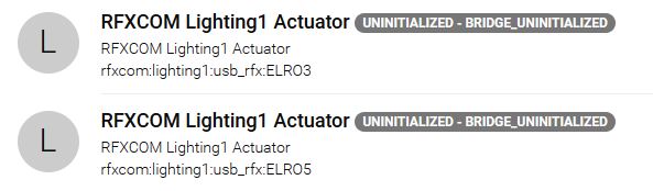

Bridge rfxcom:rfxbridge:usb_rfx [ serialPort="/dev/ttyUSB_RFX" ] {
Now how do I discover things connected to the RFXCOM antenna ?
Using the blue+ (Searching for things) …NOTHING.
Increased the debuglevel DEBUG for org.openhab.binding.rfxcom in Karaf log.
No message that helps or even mentions RFX log messages.
Searched the community and the rest of the internet for clues or (even better) solutions.
A lot of posts but nothing seems to help me
Getting somewhat frustrated…hope anybody can help.
