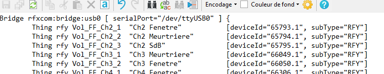

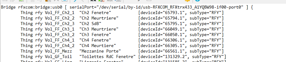

My things file
confiquration :
Bridge rfxcom:bridge:usb0 [ serialPort=“/dev/serial/by-id/usb-RFXCOM_RFXtrx433_A1YQBW98-if00-port0” ] {
Thing rfy Vol_FF_Ch2_1 “Ch2 Fenetre” [deviceId=“65793.1”, subType=“RFY”]

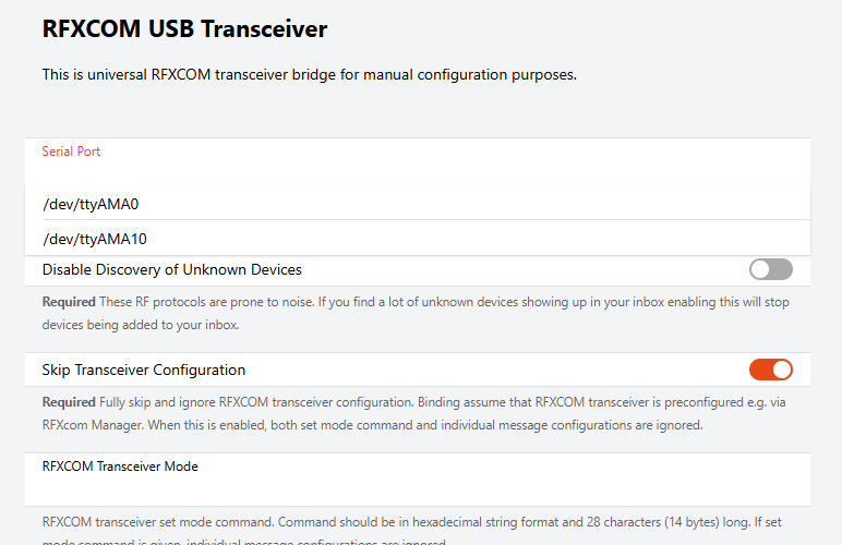

This looks fine. What does the log say?
ok for the things :+1:
The logs :
19:19:33.234 [ERROR] [.internal.handler.RFXComBridgeHandler] - Connection to RFX COM transceiver failed

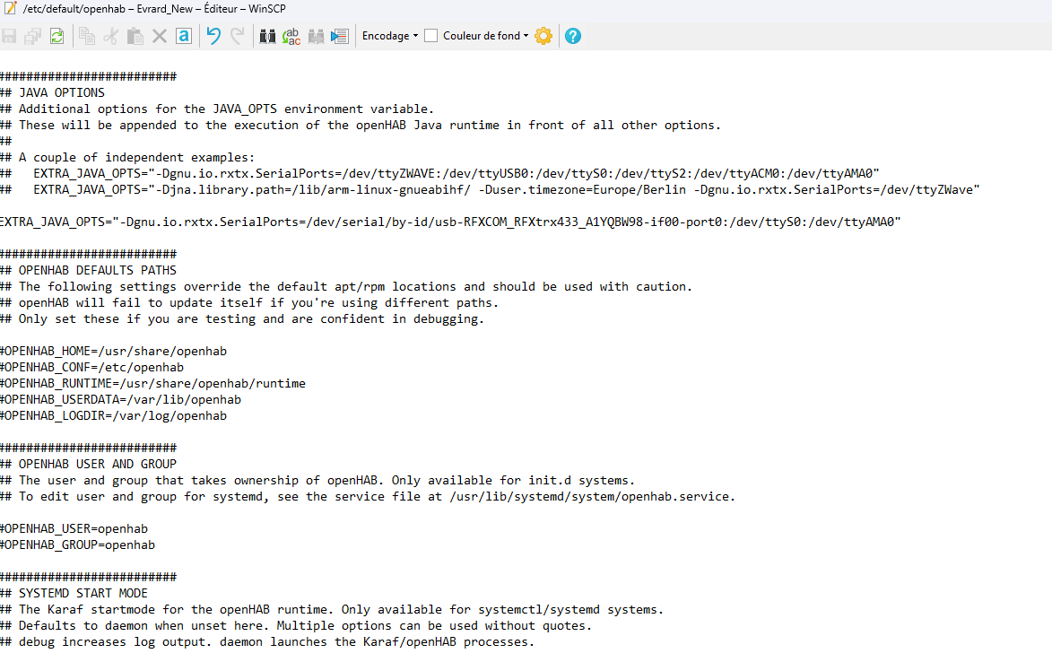

hmm, strange. Where does the link point to? Check it with ls -l /dev/serial/by-id/
Try this directly. Should be something like /dev/ttyUSB1
If this doesn’t work I’m out of ideas.

root@Raspberry:~# ls -l /dev/USB
crw-rw----+ 1 root plugdev 188, 0 Jun 28 10:27 /dev/ttyUSB0
50-usb-serial.rules
=> SUBSYSTEM==“usb”, ATTRS{idVendor}==“0403”, ATTRS{product}==“RFXtrx433”, ATTRS{serial}==“A1YQBW98”, SYMLINK+=“usb-RFXCOM”, GROUP=“dialout”, MODE=“0666”
just some thoughts:
  • why is the symlink still pointing to ttyUSB0. I thought you changed the port? The link under /by-id is created by the OS and should point to the port where the device is found
  • you shouldn’t need a startup rule anymore for rfxcom. This was needed when the binding wasn’t able to handle the symbolic link back in OH3.
  • do you have other usb devices connected? Are they running?
  • have you tried the usb ports /dev/ttyUSBO and /dev/ttyUSB1 directly in your thing definition?

root@Raspberry:~# sudo ls -l /dev/ttyUSB0
crw-rw----+ 1 root plugdev 188, 0 Jun 28 12:15 /dev/ttyUSB0
root@Raspberry:~# ls -l /dev/serial/by-id/
total 0
lrwxrwxrwx 1 root root 13 Jun 28 12:15 usb-RFXCOM_RFXtrx433_A1YQBW98-if00-port0 → ../../ttyUSB0
root@Raspberry:~# dmesg | grep ttyUSB0
[ 0.882180] usb 1-2: FTDI USB Serial Device converter now attached to ttyUSB0
root@Raspberry:~#
hope we’re getting closer​:thinking:
please show us the log when you directly enter /dev/ttyUSB0 in your thing definition.
For reference: Mine is (UI defined):
version: 1
things:
  rfxcom:bridge:RFXTRX:
    isBridge: true
      serialPort: /dev/serial/by-id/usb-RFXCOM_RFXtrx433XL_DM5WWG68-if00-port0
      disableDiscovery: true
      ignoreConfig: false
      transceiverType: 433.92MHz
      transmitPower: 1
ok, see screenshot :wink:
I have to admit I’m out of ideas. The Pi detected the device but the binding doesn’t see it. Sorry​:hugs:

There might be an issue with USB and OpenHAB because when I try to add a bridge from the UI, it offers: dev/ttyAMA0 or dev/ttyAMA10
dev/ttyAMA0 is a serial device, not USB. I assume the problem is not openhab (why should it?) but something with the underlying raspi os.
