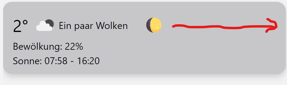

This is what looks like:
Here is the current yaml code. I am struggeling now for 2 days and am not able to find a solution. Many thanks!

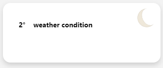

Put the icon to align on the right in the background slot instead of the header slot:
component: oh-cell
  expandable: true
  background:
    - component: oh-icon
        icon: moon
        width: 40
        style:
          position: absolute
          right: 10px
          top: 10px
  header:
    - component: f7-block
        style:
          display: flex
          flex-direction: row
          align-items: center
        default:
          - component: Label
              text: 2°
              icon: weather.png
          - component: Label
              text: weather condition
good idea. works fine. Thanks you very much Yannick

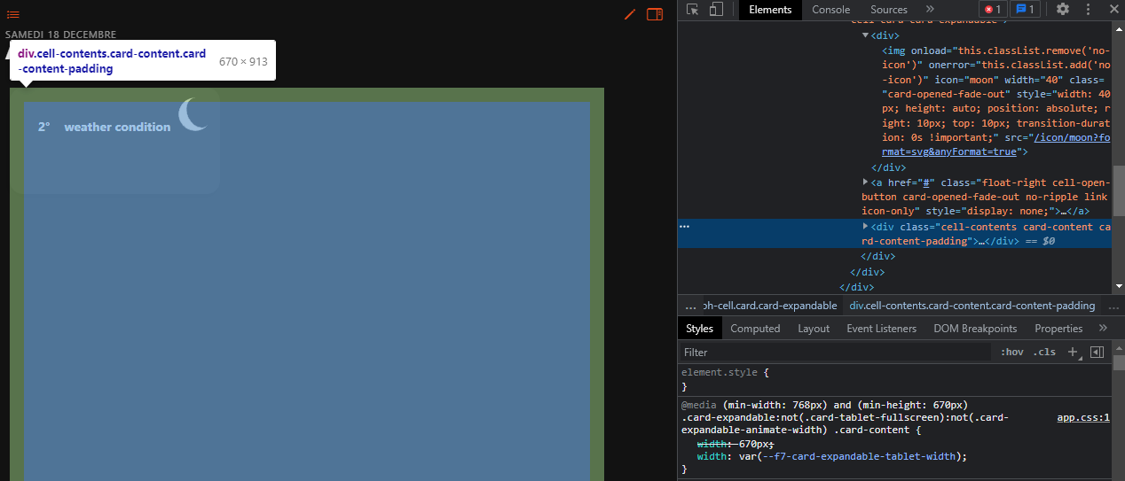

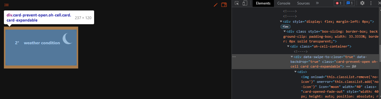

You won’t find a solution that doesn’t involve the background slot because widgets in that slot get added to a container that matches the width of the cell when not expanded:
whereas what gets added to the header slot gets added to a container that has the width of the card when expanded:

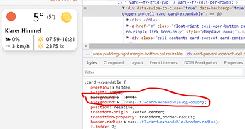

EDIT: hmmm. after leaving and re-opening the yaml code editor the widget is now showing up with a different background color. so, that is being solved.
If someone has some useful tips as to where to make the code smarter, they are more than welcome.
When using the background slot I am not able to control the background color anymore by whatever control I try.
Sounds to some extend logically but I thought at least by setting the background of the f7-block I should be able to override it.
