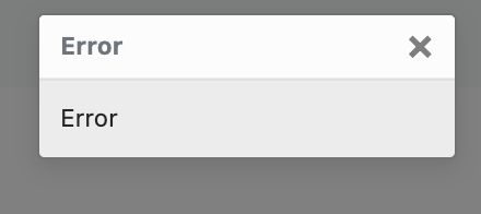

I tried to create a new device with the XML posted above but when I press create an error appears at the top right (though the server responds with a http 200 ok in the background).
Do you mind have a look at that?
