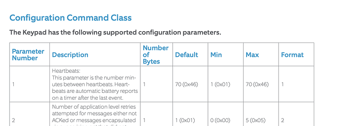

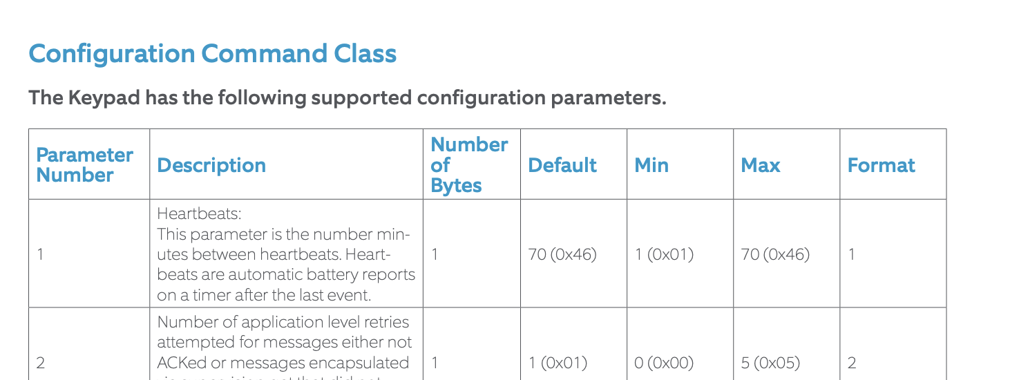

As I have never done that before and want to be accurate, here are some questions:
  • With respect to the parameters: is this what is called “Configuration Command Classes” in the manual?

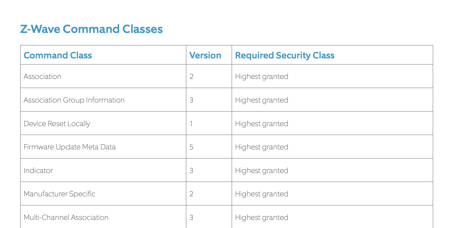

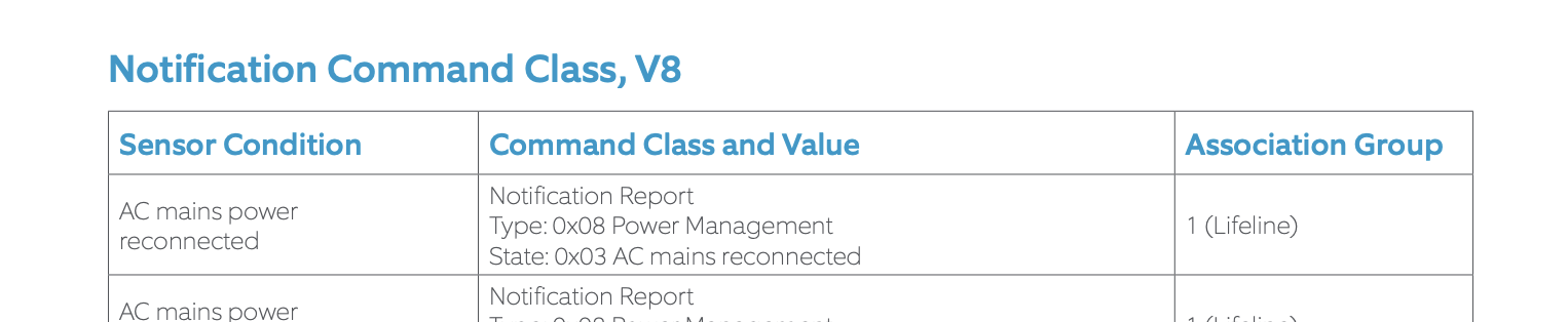

  • Do I have to update / verify / check the notification command classes in the endpoints tab?
  • Do I have to edit the command classes somewhere?
Yes, that’s correct. You just need to add this information into the “Parameters” tab in the database.
You shouldn’t need to. I would suggest to leave it alone, and if it doesn’t work, then we’ll look at this in more detail.
No - this should already be correctly imported from the XML.
