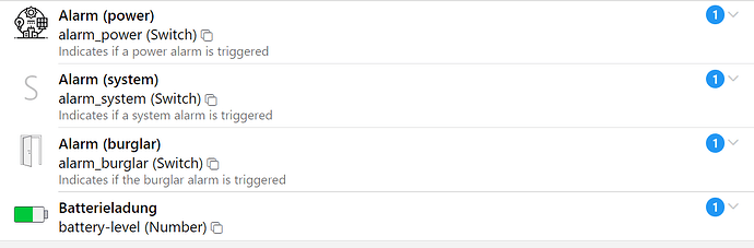

This sounds like burglar - I don’t know how this might be related to the channel:

The good news is I see Node 6 and 7 fully initialized. The bad news is node 12 (I’m assuming this is the motion detector) does not get to the point of initializing channels. I do not know if it is expecting security. I’m beyond where I can help on that. How are you getting these steps done?
