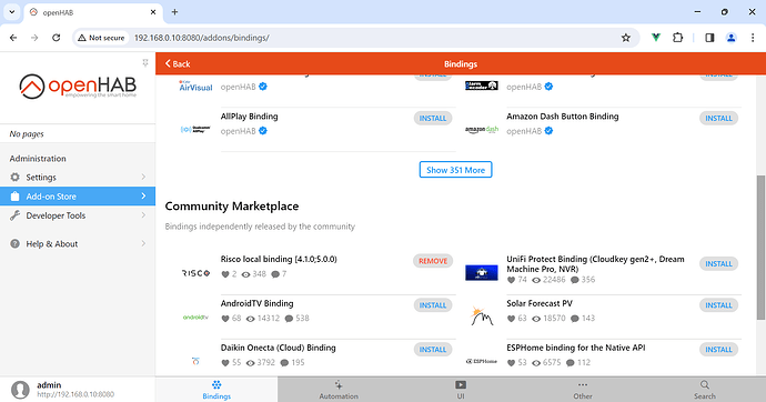

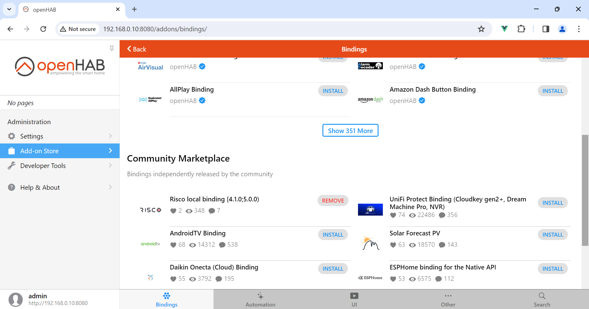

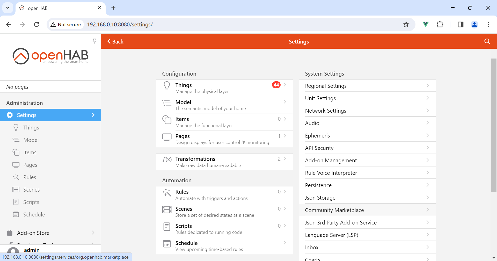

First the binding need to be added to the openhab installation.

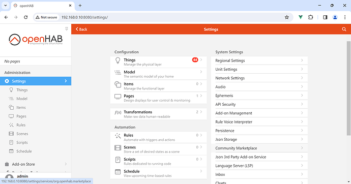

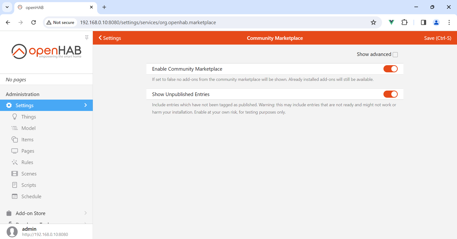

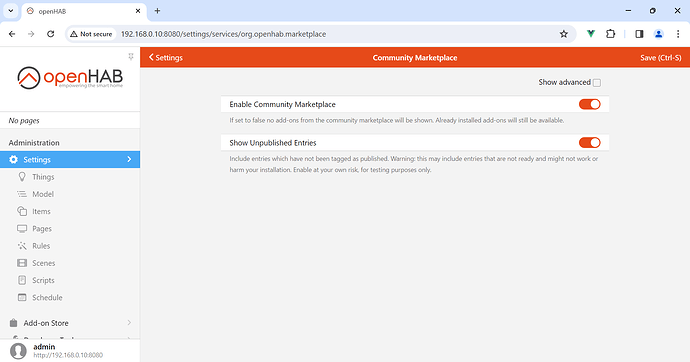

On the Settings page, press on “Community Marketplace”
Enable both “Enable Community Marketplace” and “Show Unpublished Entries”.

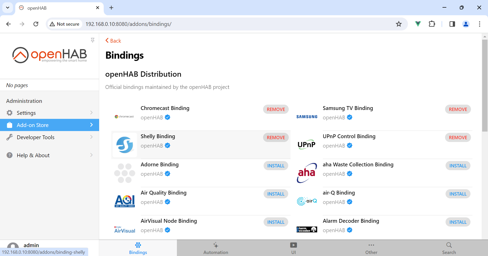

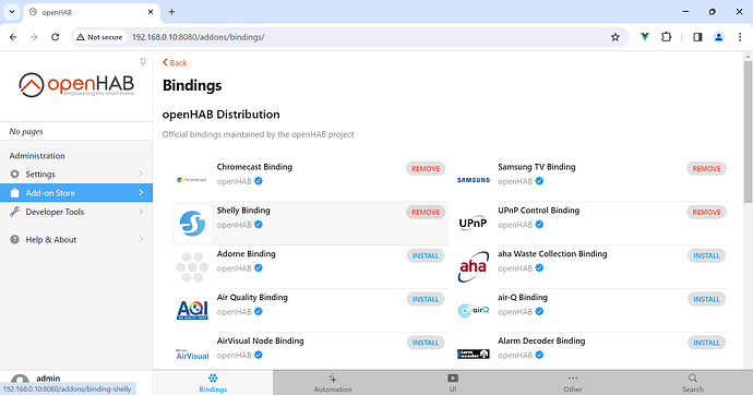

Press on “Add-on Store”
Scroll down to the “Community Marketplace”, locate the “Risco local binding” entry and press install.

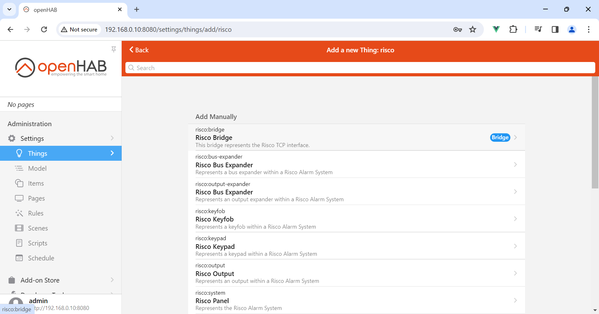

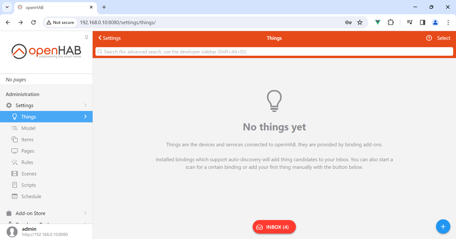

On the Settings → Things page, press the “+” Button on the lower right corner.
Select the “Risco local binding”.

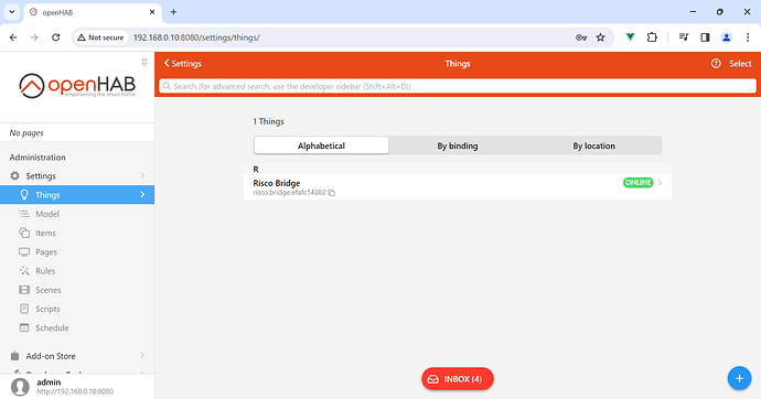

Select the “Risco Bridge”
Fill-in the Hostname or the IP address.
Resulting Things List.
If the Risco Bridge is not getting ONLINE, probably some of the Bridge default settings values need adjustment.

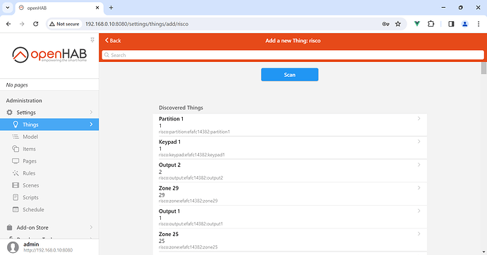

With the Bridge ONLINE, press again on the “+” button in the lower right corner and select the Risco local binding.

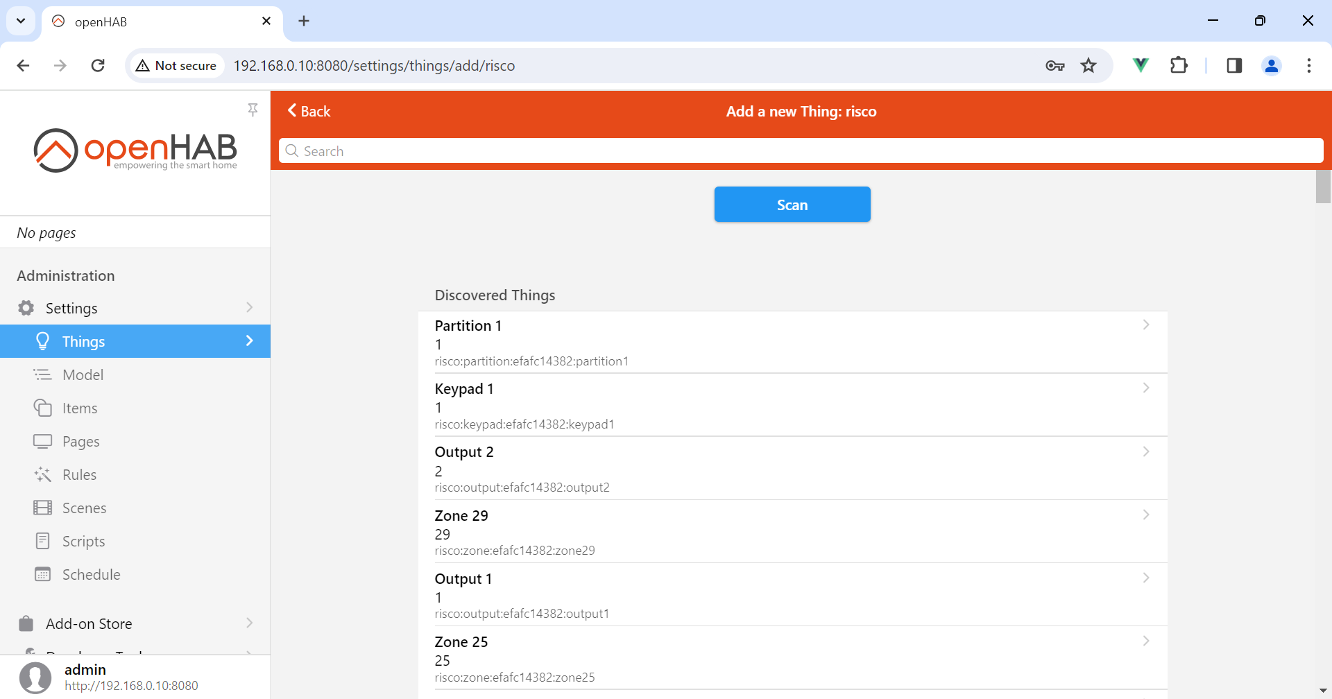

In the next screen press the Scan button.
As a result, all the discovered things will be in your Inbox.

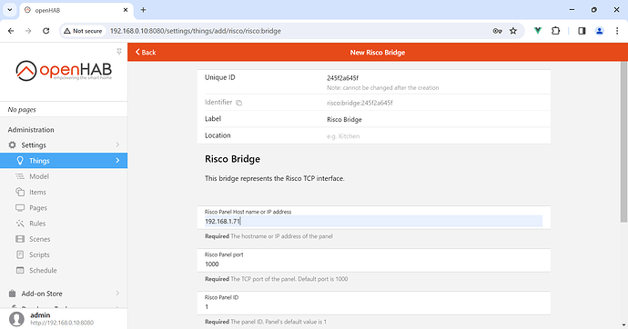

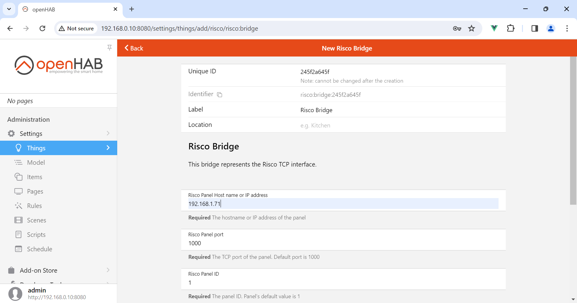

Hi @stamate_viorel,
first you have to create the “Risco Bridge” manually.
Settings → Things. Press on the + (Plus) Sign. Select the risco binding. Click on “Risco Bridge” in the “Add Manually” list.
There you are presented with the config parameters you have to enter.
  • IP address of the panel
  • The port (default: 1000)
  • The panel id (default: 1)
  • The communication password (default: 5678)
  • The communication encoding (default: utf-8)
  • The initial connection delay (default: 0)
Except the first setting (IP address) the rest of the settings have the default values pre-specified.

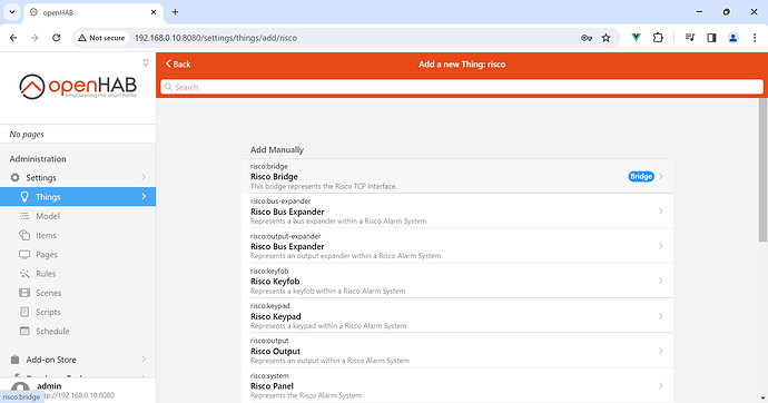

Hey thanks for the reply. Well I don’t know for the life of me why but there is no binding to select in the ui. I even clean the cache everything but your binding doesn’t show up. I think I have some knowledge about openhab but I do not find any sign of your binding except the karaf console.
But I am glad someone is actually working on this.
You need for sure openhab 4. I only tested with 4.1 :slight_smile:
That’s the reason the marketplace binding is in alpha state and not yet published…

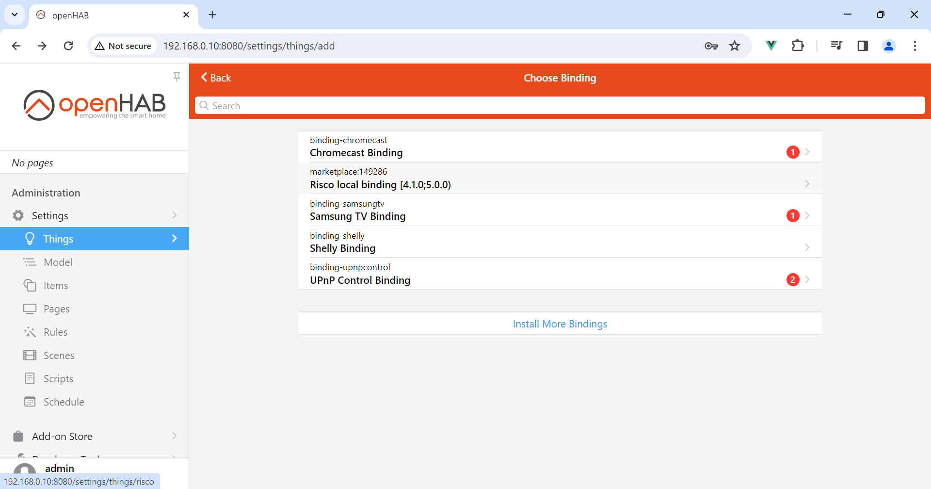

I also can’t get it to work on 4.1
It’s active when I list it in the console
280 │ Active │ 80 │ 4.1.0.202310291653 │ org.openhab.binding.risco
But I’m unable to create a bridge, the addon is completely not visible in the GUI. Also cleaning the cache did not help unfortunately.

Hi jossuar,
Many thanks for looking into this. But also with this new addon, I still can’t select the irisco binding when trying to add a Thing, to add a bridge.
Although it’s loading it as I can see from the logs:

Hi Jossuar,
Thanks, but I’m not even getting the option to choose the Risco binding. When I click the + sign in the things page, the risco binding is not there. All the other bindings are.
Although, from the openhab logs, you can see it is loading.

Hi Steven,
no there should not be anything else needed.
I did test the installation, by installing directly from the community marketplace.
I have added to the first post the binding installation process.
If you add the binding from the marketplace, delete it first from the addons folder.
