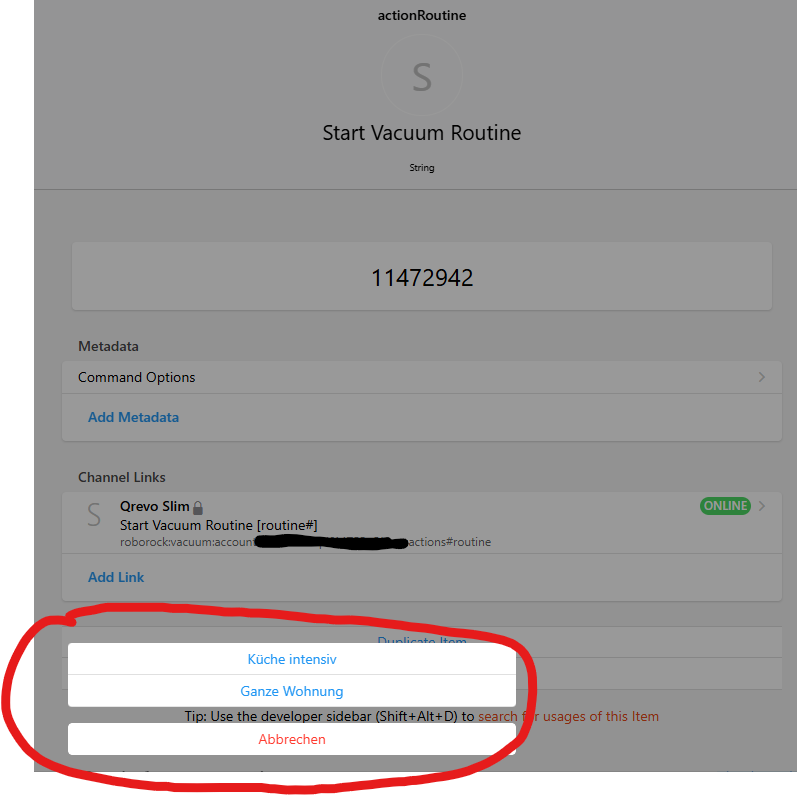

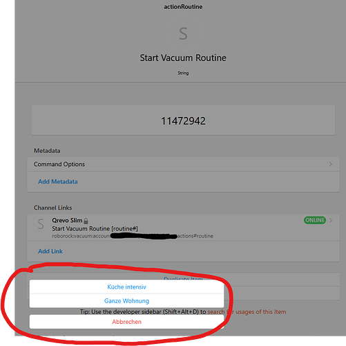

FYI I have a small javascript rule that updates the command options of the actions routine item. This will make it possible to easily select the routines you created in your app via dropdown.
@Paul_Smedley maybe it’s a nice feature to implement this directly for the item linked to actions#routine channel. Sonos binding does something similar with favorite channel.
Items:
String                  actionRoutine         "Start Vacuum Routine"                                                         {channel="roborock:vacuum:account:xyz:actions#routine"}
String                  infoRoutineMapping    "Routine Mapping"                                     (gVacInfo)         {channel="roborock:vacuum:account:xyz:info#routine-mapping"}
Rule:
rules.JSRule({
  name: "Roborock - Update command options of action routine item",
  description:
    "This rule sets and updates the command options of the roborock action routine item to the routines set in the app when they are updated in the app",
  triggers: [triggers.ItemStateUpdateTrigger("infoRoutineMapping")],
  execute: (event) => {
    const actionRoutineItem = items.getItem("actionRoutine");
    try {
      // string from item: e.g. { "6264197": "routine 1", "6363070": "routine 2" }
      const options = Object.entries(
        JSON.parse(items.getItem("infoRoutineMapping").state),
        .map(([routineId, routineName]) => `${routineId}=${routineName}`)
        .join(",");
      // update command options
      actionRoutineItem.replaceMetadata("commandDescription", " ", {
        options: options,
    } catch (error) {
      console.error(error);
  tags: [],
