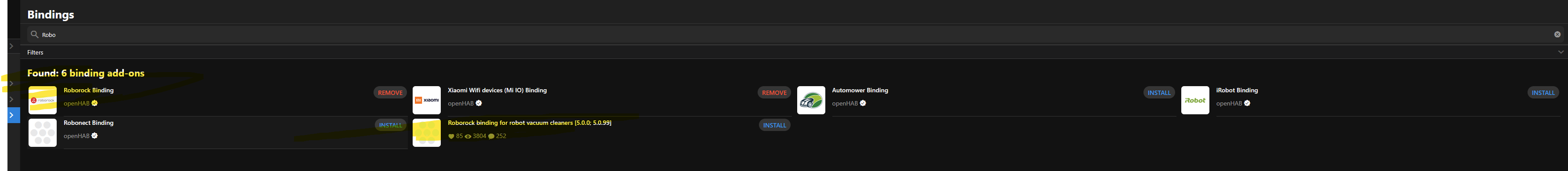

Hi Paul, Im using 5.1.0 and I see two bindings. Which should I be using for the S8 Ultra? Despite getting my thing online for the account and vaccum, I cant get it to control the vaccum at all.
Cheers
For 5.1.0 you should really only see the OpenHAB version - unless you previously installed a binding manually in /usr/share/openhab/addons ?
Is the S8 Ultra detected and appear in inbox? If not, trace logs please :slight_smile:
I see this, but im using the OH version
Yes, its online as is the account
The one on the right is the marketplace version, which shouldn’t show up in 5.1.x?
Trace logs should show why the vac isn’t being detected.
But it does. Change [5.0.0; 5.0.99] to [5.0.0.0; 5.1.0.0) in thread header will fix this. openHAB checks 4 digits, don’t ask me why.
